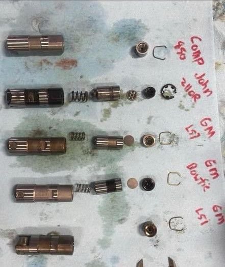

Default Lifter internals
Here's a view of some disassembled lifters my buddy sent to me. The original LS1 lifters don't have much to them.
