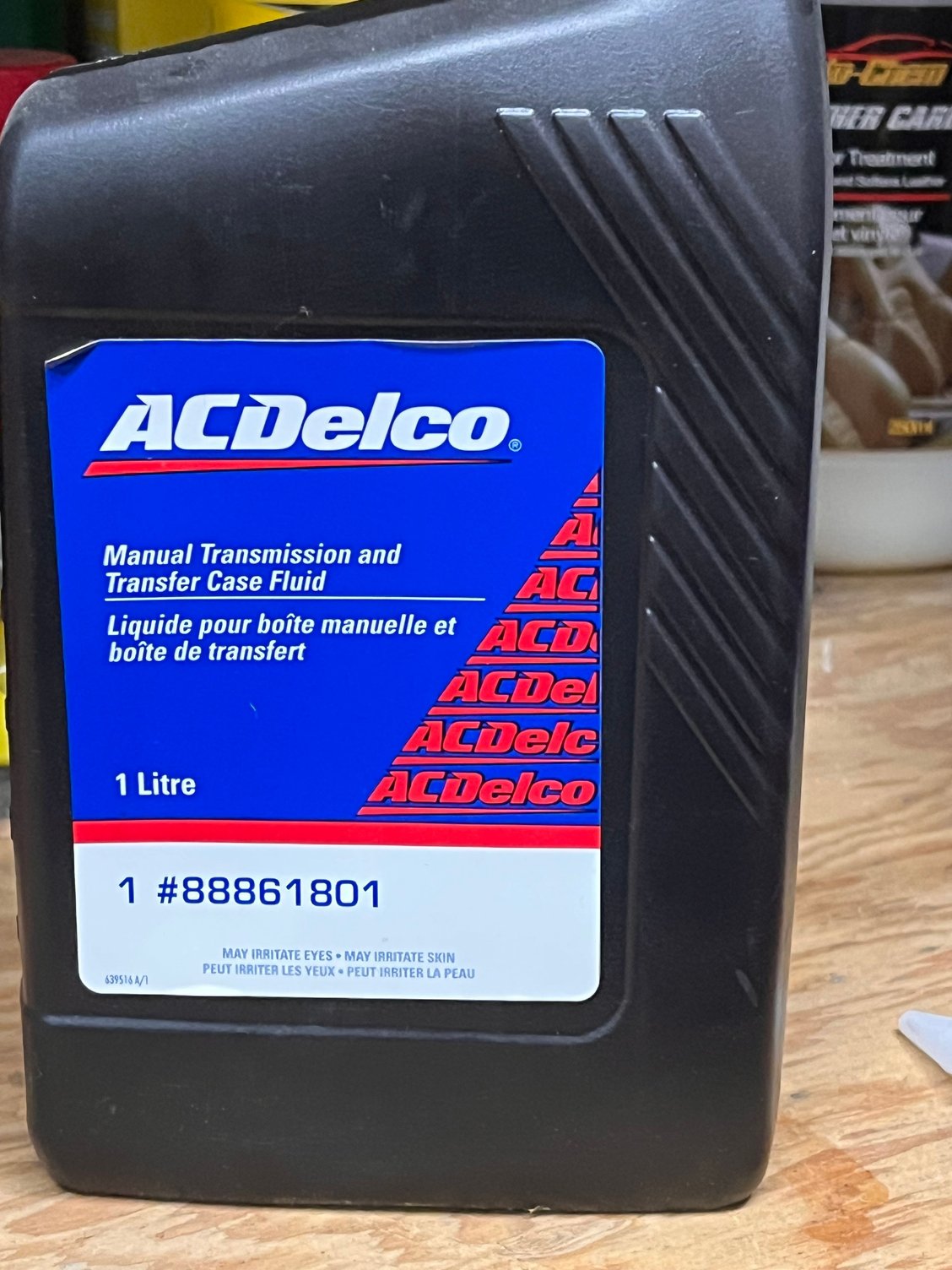

Originally Posted by Prop Joe
I have a 98' with the "Paper blocker rings" I did hours and hours of research. In the end I went with the current GM/AC Delco Manual gearbox flavor. PN 88861800. Its a mineral based fluid. The Summit search engine does not list the C5 specifically, but does list this for all Tremec trans used in Corvettes C6 and C7 including the ZR1. In the comments section a couple C5 owners reported in using this fluid as well.
https://www.summitracing.com/parts/ADO-10-4033
GM Tech link on the subject:
https://web.archive.org/web/20140617...hlink/2009/05/
"TIP: Any vehicle that previously used DEXRON-III for a manual transmission or transfer case should now use p/n 88861800 (88861801 in Canada) Manual Transmission and Transfer Case Fluid."
Another tip:
"All licenses for DEXRON-III expired at the end of 2006 and will not be renewed. Fluids sold in the market after that date bearing claims such as "suitable for use in DEXRON-III applications" or similar wording should be avoided, because 'DEXRON-III' fluids are no longer checked and policed by GM and therefore may not be the originally tested and approved formulation."
YMMV
looks like you’re referring to this, I still have a half quart from my previous 2012 Zr1 and I was not sure if it was compatible with my C5Z . Thank you for made it clear

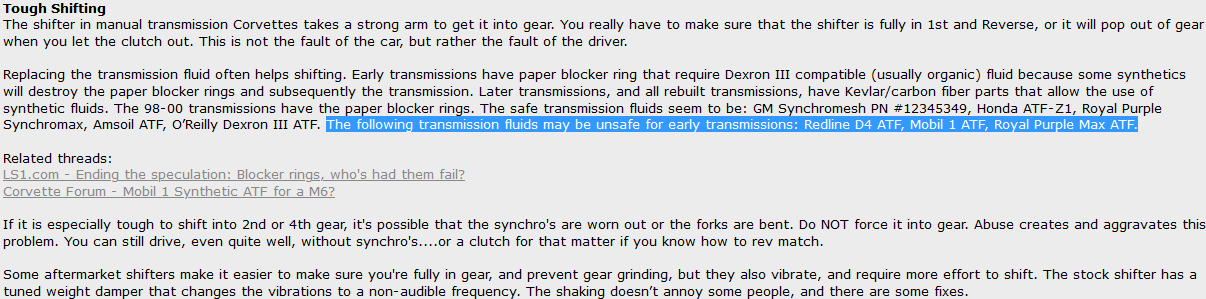

As part of your investigation, did you consider Redline D4 ATF? It is what Redline recommends for our cars.

I have a 98' with the paper blocker rings in the MM6. Newer 2001 and up you can use what you want. Yup I did research the Redline as I have used their products on other cars. I looked on this forum, C5 General, Sticky by Chris Draper. Link here:
https://www.corvetteforum.com/forums...fo-thread.html
Here is a snip:
To Synthetic transmission fluid
