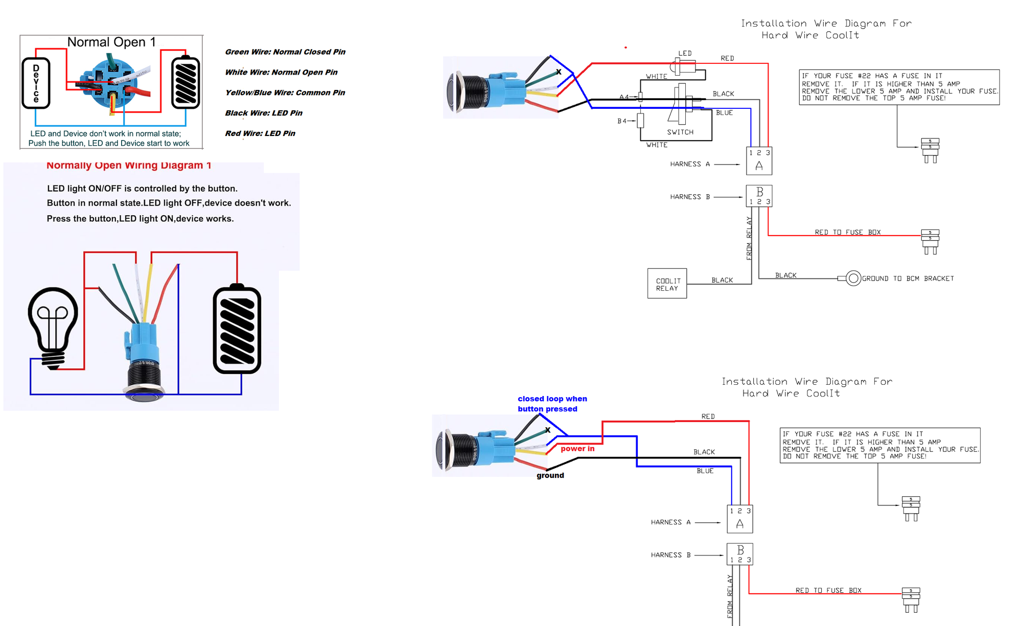

I've bought the H2 kit, and I'd like to change the button but I don't know much about electrical. I'd like to have the button match the other buttons I'm mounting for other auxiliary items in the car.
I have asked them directly but they are unsure without testing so I'm wondering if anyone here as a more definitive answer if my new switch will work versus there's. Of course the manufacturer of the switch is hard to nail down, and a lot of the sellers aren't sure about what I'm asking.
Info about the switch I intend to use:
DMWD 2PCS 19MM Latching Push Button Switch 12V-24V LED
Pre-Wired Socket for 3/4" Mounting Hole
Current rating 5 AmpsGreen Wire: Normal Closed Pin
White Wire: Normal Open Pin
Yellow/Blue Wire: Common Pin
Black Wire: LED Pin
Red Wire: LED Pin
Diagram of the SCC and my intended wiring setup attached for your review.
~Per SCC I have to make sure NO power goes through the wire the goes to the gray relay that that plug into the fuse box.
