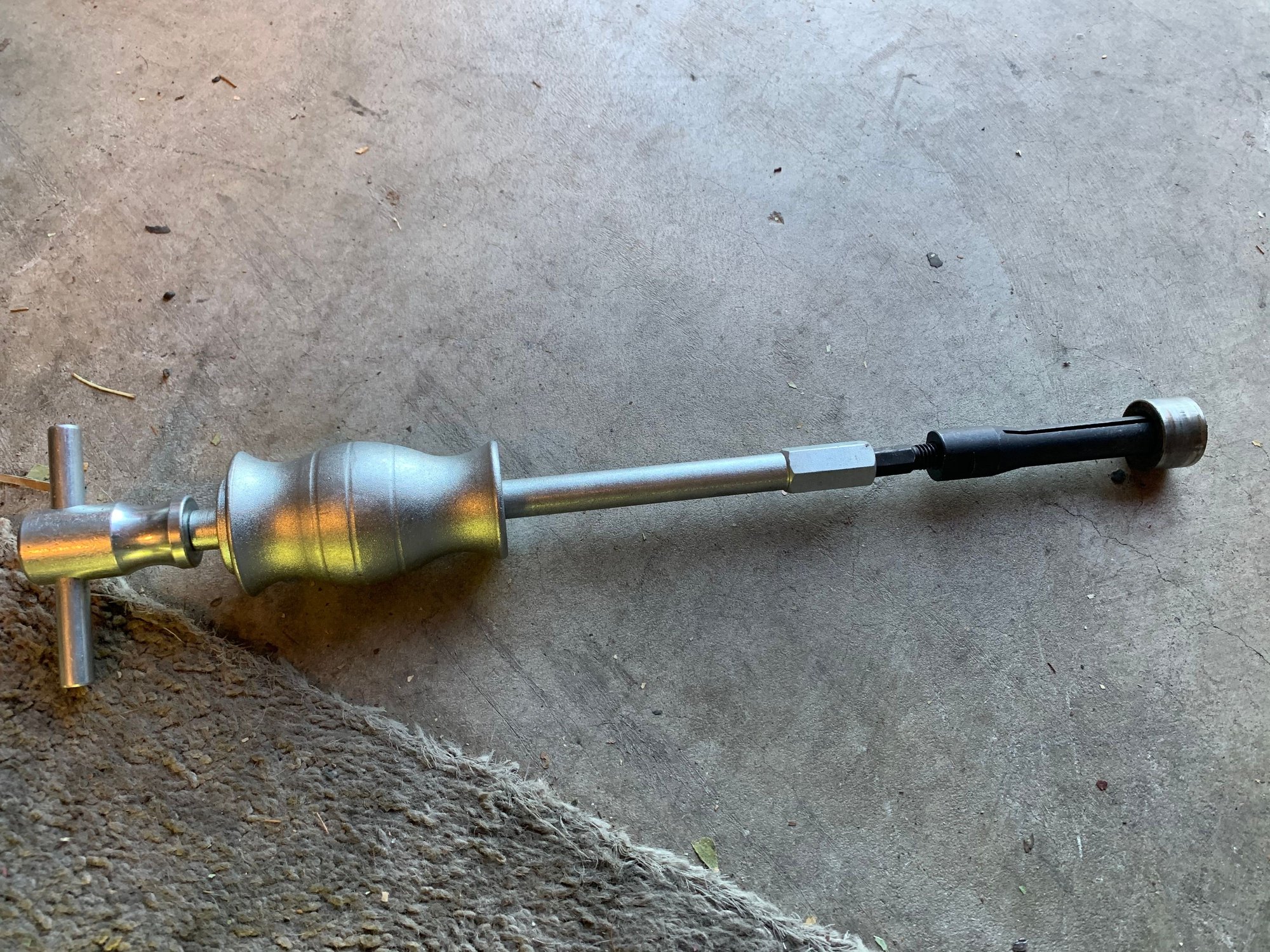

I used this kit
Amazon Amazon

So you modified a rental tool??? I like JDM's back/slide hammer tool.

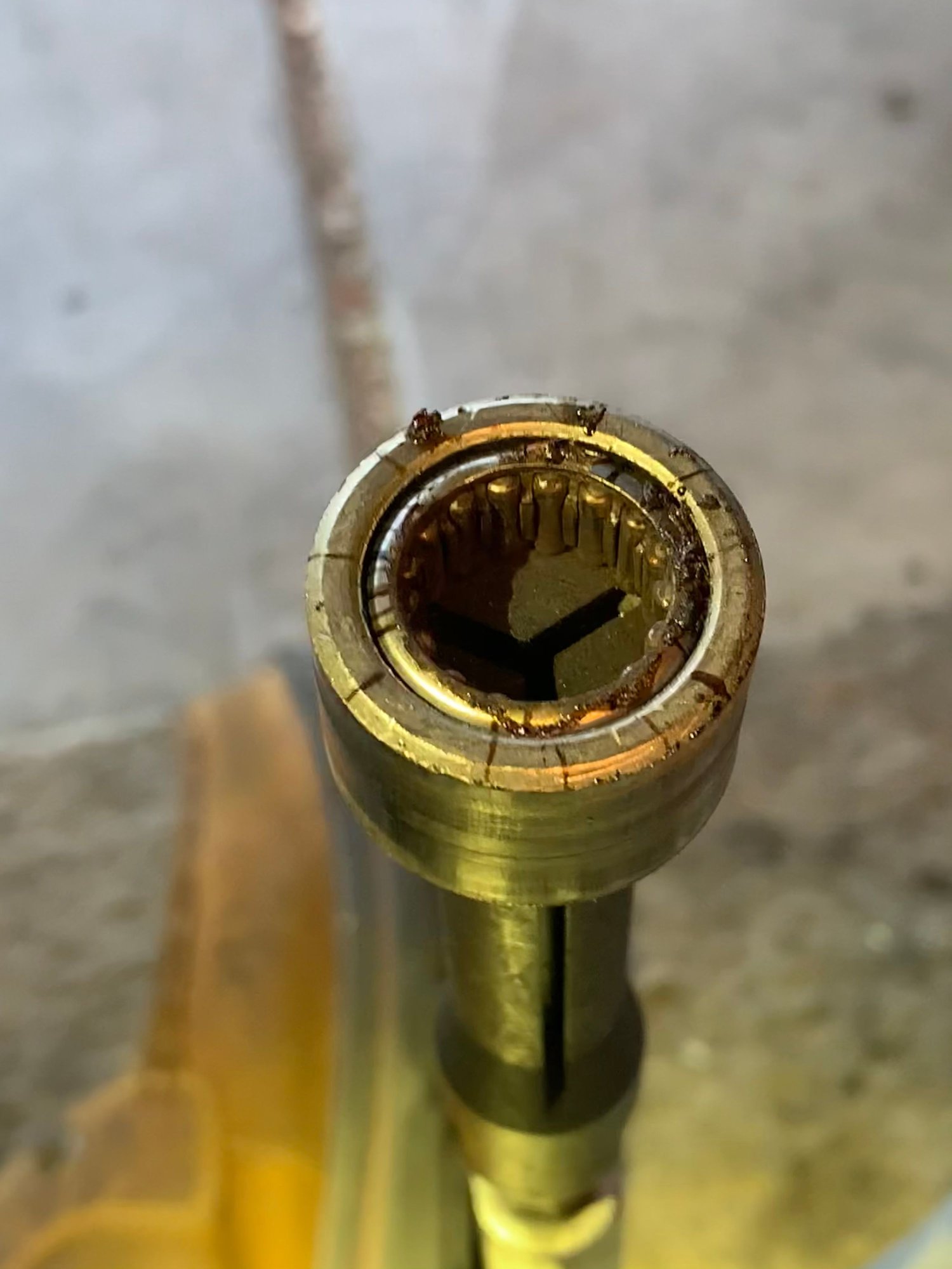

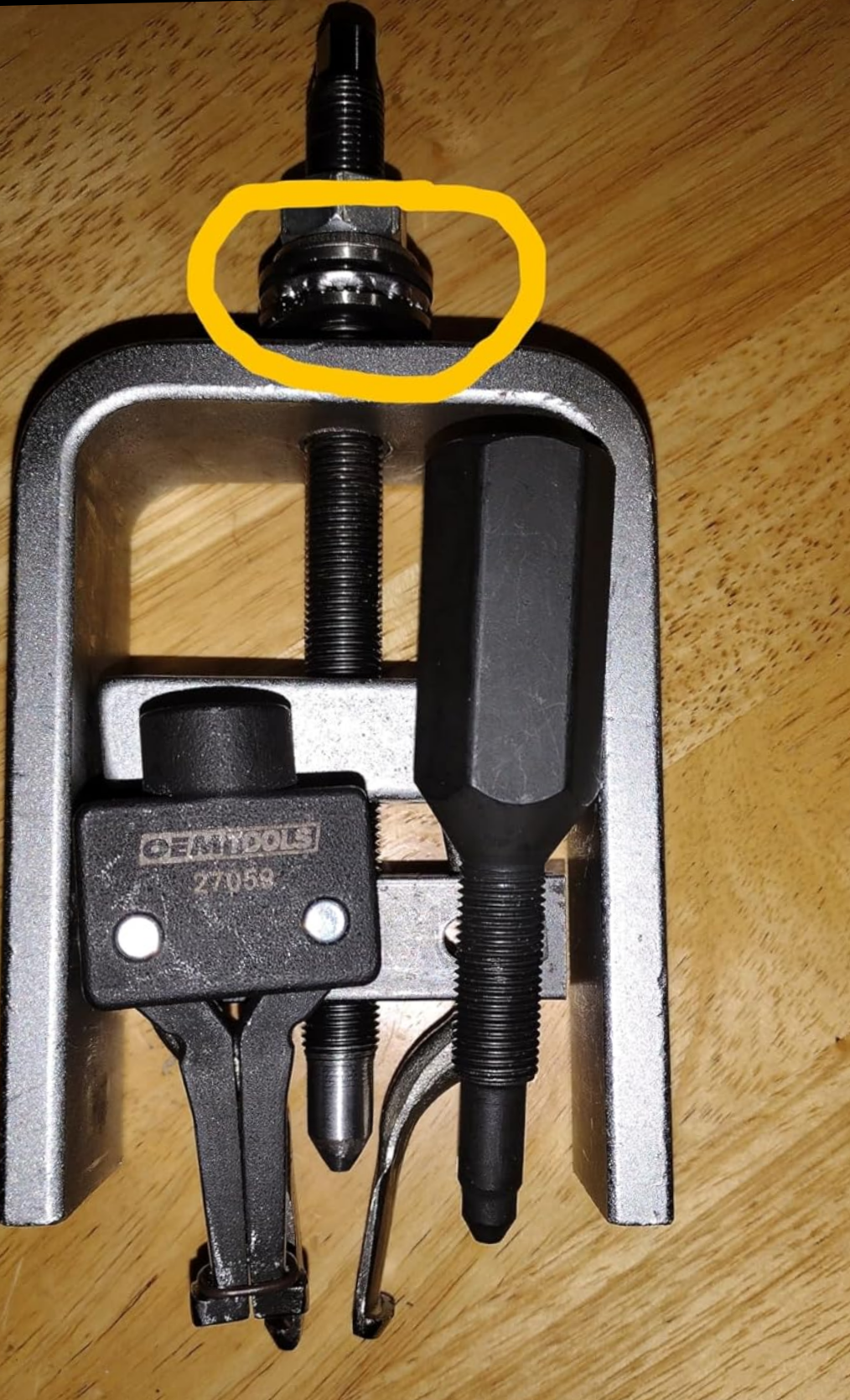

HD otc easily slipped. Stuck in billet crank. Nothing to lock the fingers. destroyed the roller bearing. Started to cut this pilot out.
HD moded OTC with thrust bearing, ground Taper OTC Merged, moded OEM brand locking fingers. Will NOT slip. Effortless, Smooth action

Originally Posted by jdmvette
Ordered. Thanks. Definitely looks to be the better of the two with clearly more weight in the hammer.
