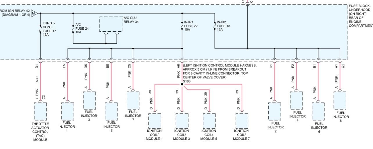

With a DVOM you can do a “voltage drop” check across the ignition switch contacts…place one lead of DVOM on battery positive and the other lead on fuse 17 (Throttle Control)…while cranking you should see no more than 0.1-0.3 volts on your DVOM…if you see 7 volts for instance you are only getting roughly 5-6 volts across the ignition contacts…you can check the other fuses downstream of the ignition relay.
