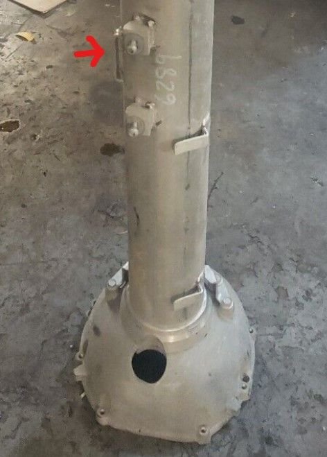

This is the original shifter and shifter box from my 2002. Notice the angular piece (hard rubber) that protrudes from the bottom of the shifter box. This will fit in a corresponding groove on the torque tube. Remove the foam and you will see the groove. Slip the angular piece into the groove, rotate the shifter toward the passenger side and the mounting holes should lie flat on the torque tube mounting holes. On the Tmod box I installed the angular part was machined into the box and not rubber like the factory box.
Stock shifter and box.
Angular mounting tab.

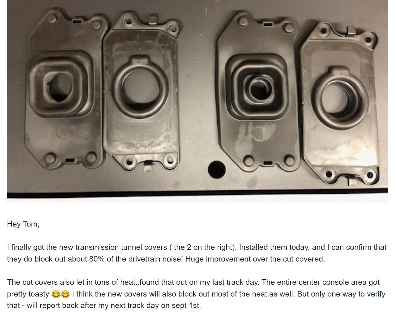

The other issue you may run into is when you put the rubber boot over the stock shifter. When installing an MGW a portion of the rubber bellows need to be removed so you will have a gap with the stock shifter in place. If you go to the MGW website they have videos showing the installation and you can see where the boot is cut.

I believe the MGW install is where that foam comes from, it's not bad but it is in the way. You need to make sure that rubber piece on the fin on the bottom of the box, I call it the foot, is attached to the box and that fin goes into the slot on the torque tube FIRST thing. It won't fit with that foam under the box. The boot is your next problem, here is the slot on the tube that foot goes into and the difference between the boot before and after it's been cut / opened up to accommodate the aftermarket shifter. If you want to run the stock shifter the best thing you can do aside from replacing that boot and removing that foam is to send it in to be upgraded and to replace the bottom pivot bushing on the stock shifter. These two upgrades make a significant difference in how that stock shifter or any aftermarket shifter will feel on the box. It will be smoother, have les slop and stay that way forever. If you send in the box I can have it back in the mail in a day or two.
