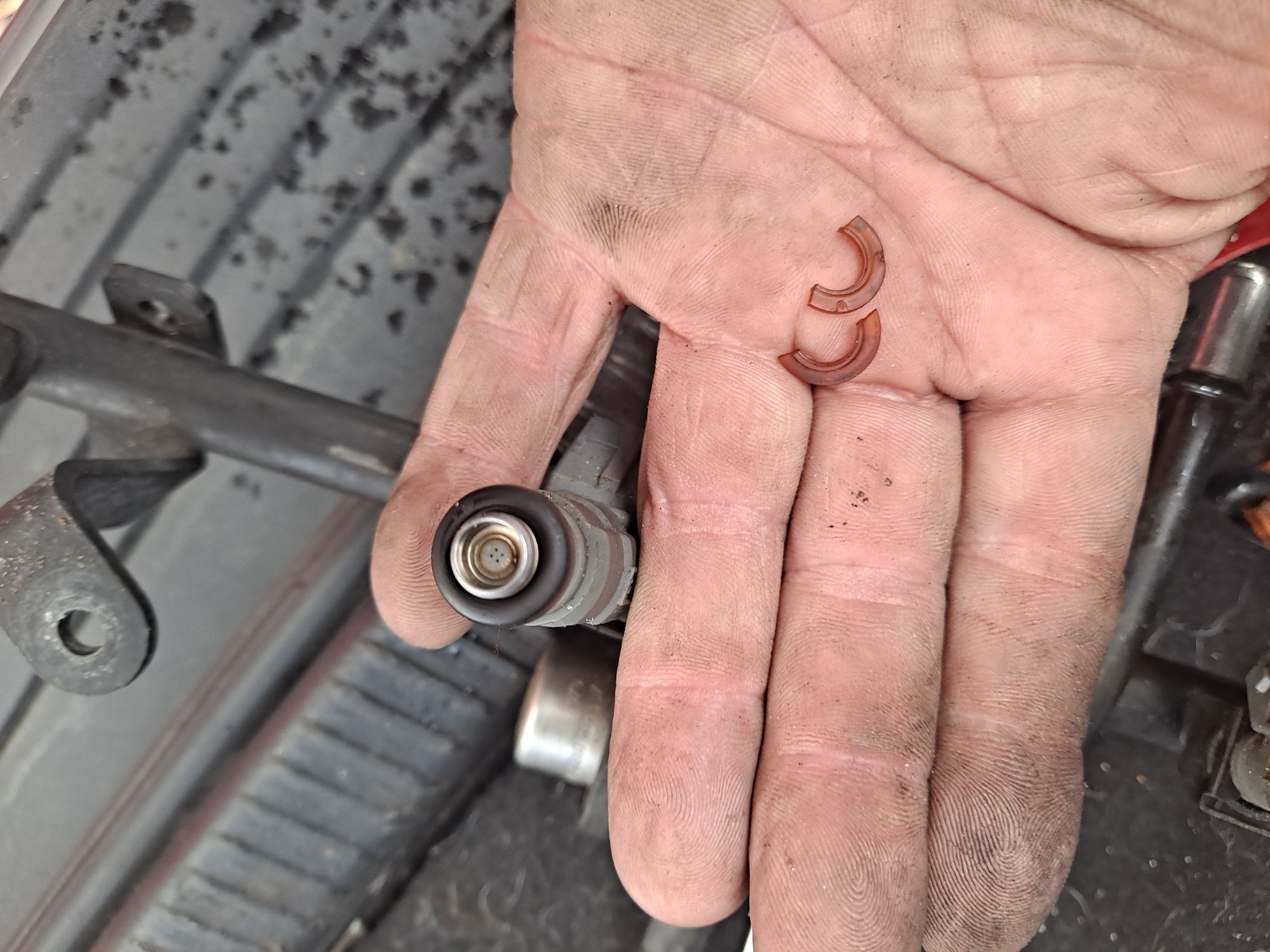

While pulling the injectors out of my old manifold one of the brown plastic washers broke in half. Are these needed and if so where can I get just it, or do I have to buy an injector in order to get it? TIA

^^ Not looking for the o rings, looking for the plastic washers underneath as I posted.

Sorry, was looking at the photos while on the phone, lost too much detail. Plus, my most recent injector experience was on a '99 Triumph and the original O-rings split and fell apart in almost an identical pattern as your bushings. Lame excuse for my lame response.

No worries. The parts stores do have the o rings, but no washers. I found a reseal kit on ebay that has a full set of rings and the washers, even the little filters baskets. Woo Hoo!

I thought of that however they are not flat washers, the have a little flange around the ID to support the o ring I suppose. They are supposed to be delivered today however they are not in the mailbox as the USPS claims they are.....

I did some late night investigating. Turns out the "washer" is called a pintle cap and is used for a couple of reasons. One is to retain the o ring to keep from it getting stuck in the manifold when the injector is removed. It also serves as a heat shield for the actual o ring. Of course there are several types depending on the injector and make of vehicle. Our LS1 uses a Bosch type 3 injector and there are several different pintle caps available for them. Ours uses what is called a "flat" pintle cap. Getting them off is easy as it just requires breaking or cutting it off. Putting them on is somewhat of a bitch, heating them with a heat gun makes it easier, also they go on before the o ring, it is stretched over the cap once the cap is installed. More info to come as I get into this.

I broke the pintle cap on the fuel rail side of one of my injectors. I decided to reuse it anyway as there's an injector clip that holds things in place. No leaks so far.

If is was the one at the rail I would do that as well. However it is the other end at the manifold, I envision the broken part going into the intake port. I suppose I could take the manifold off to do it.
