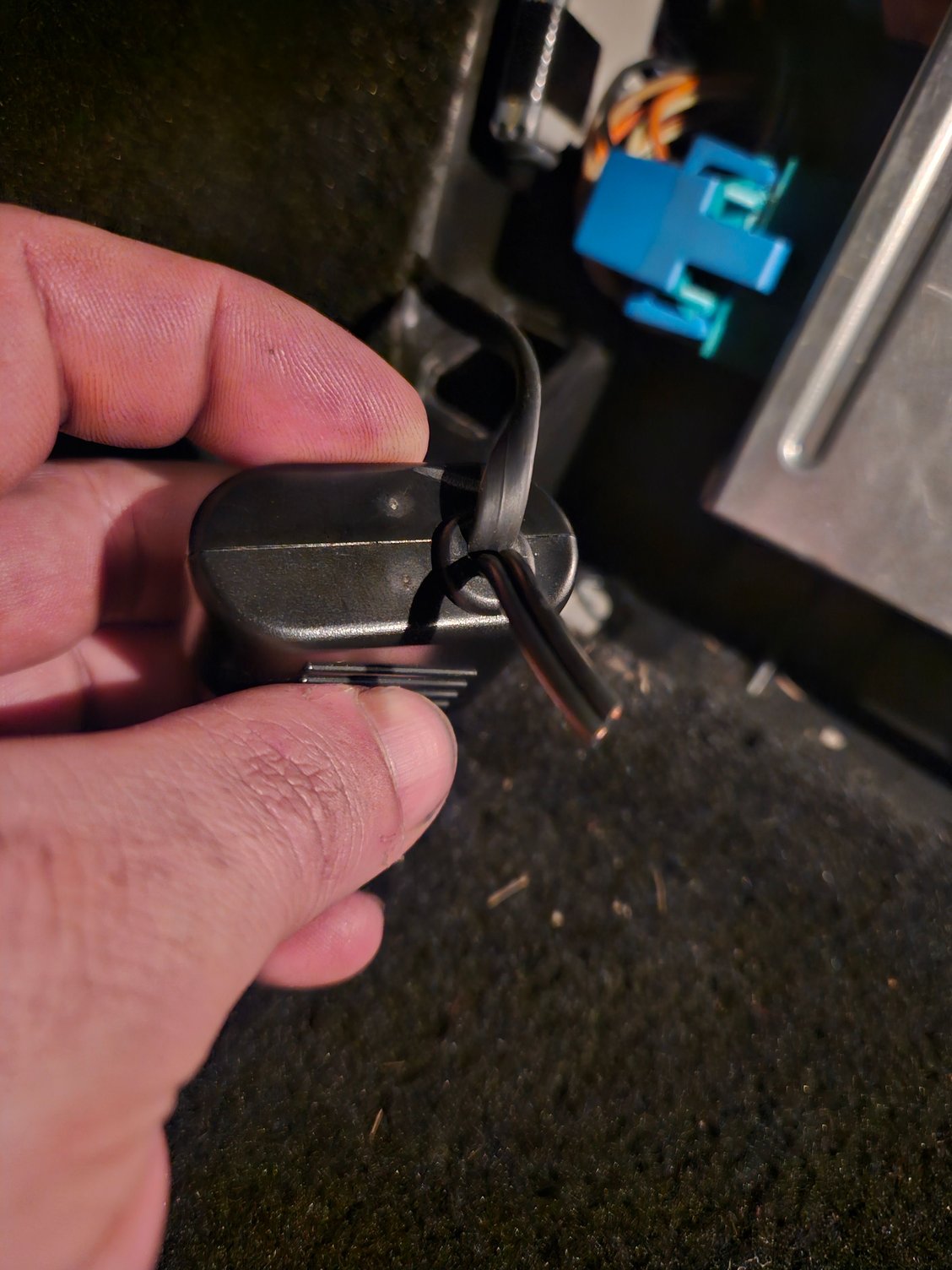

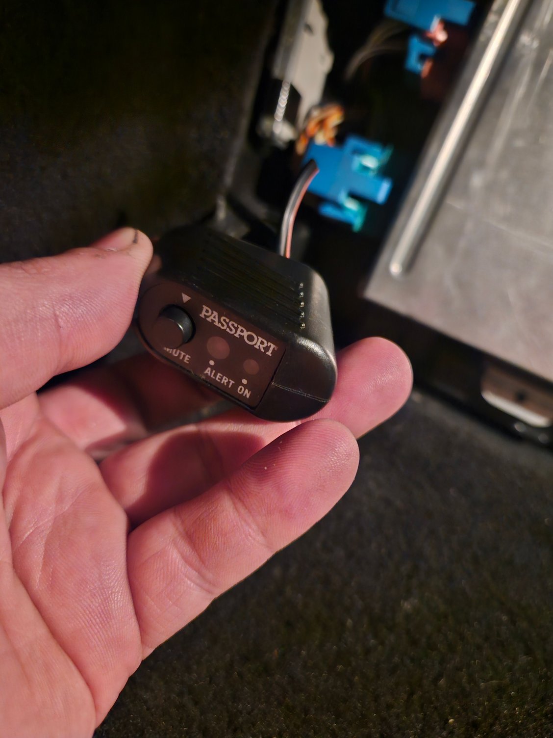

I found this next to my BCM trying to trouble shoot this problem, does anyone know what this is? Or why two of the wires lead nowhere?
It’s a power cord from a radar detector. I suppose someone hardwired it in.

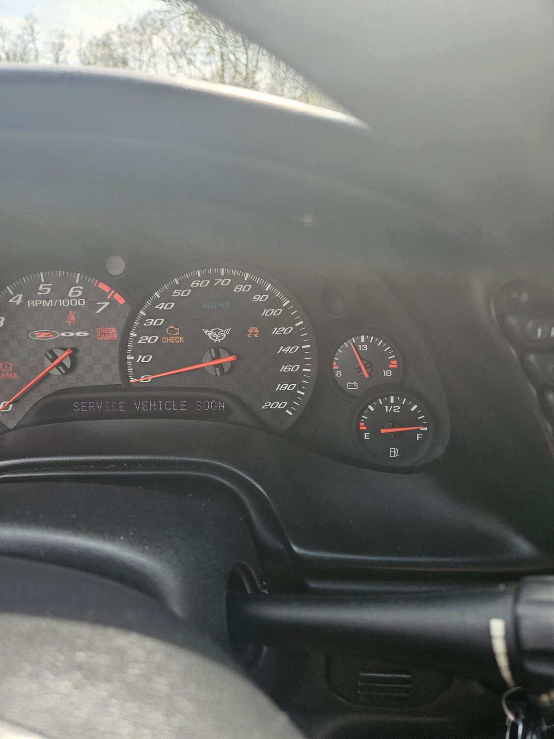

I have another question.
Whenever I remove BCM connector C2(middle connector), all my DIC gauges spring to life.
Is this a sign of a bad BCM, what all does it connect too and could this be my culprit?
Any insight would be helpful.

You will have to get a wiring diagram to find out what that connectors wiring goes to, there's no easy straightforward answer to your question.
