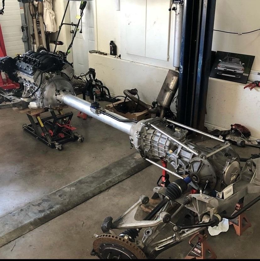

What is your budget? I picked up C6Z trans, diff and cradle for about $5k total.
I’m not sure if the C6Z diff will bolt up to the C5 T56.

It does. RKT makes offset mounts for it to sit in the right spot though or you need a c6 rear cradle
What does that install look like? Does it bolt right up?
no, look it up, lots of info
