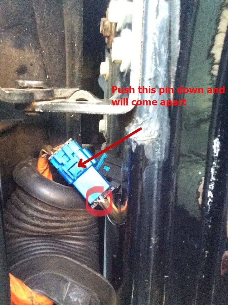

Is there a tool to disconnect the harness to power the door? Having a really hard time getting it disconnected to inspect the connectors, and it looks like there is exposed wires at the connector.. any ideas? Thanks

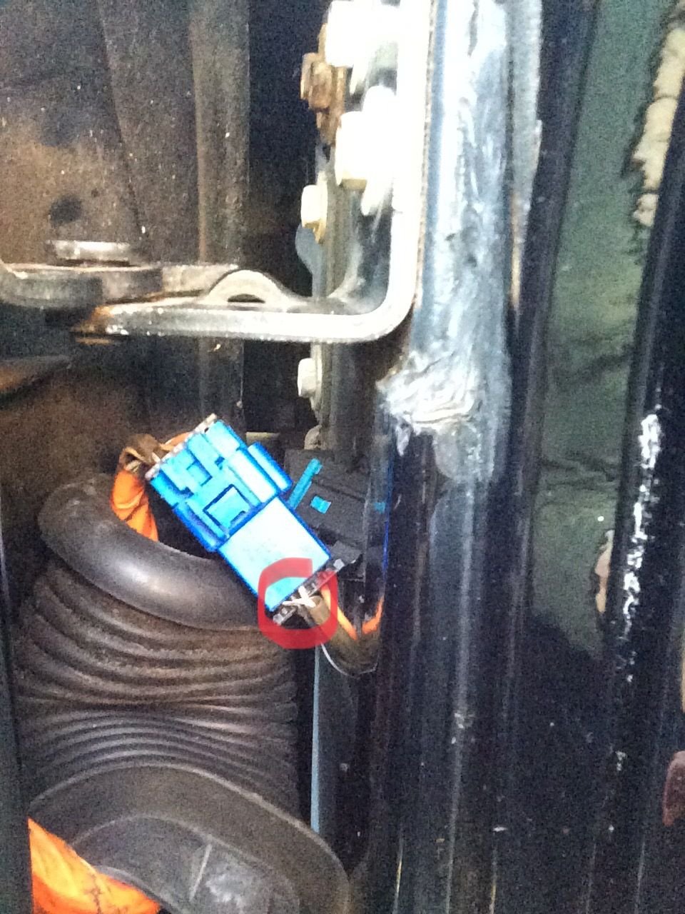

Old Mar 26, 2024 | 07:40 AM
ckreider33's Avatar
ckreider33
Joined: Aug 2014
Posts: 65
From: Upper Montclair New Jersey
Perheiro,
Thank you for the reply. If I just need to push hard on that pin I think I can get it disconnected without a tool.
It's going to rain for a day or two so I will try when it stops raining. Your help is much appreciated.

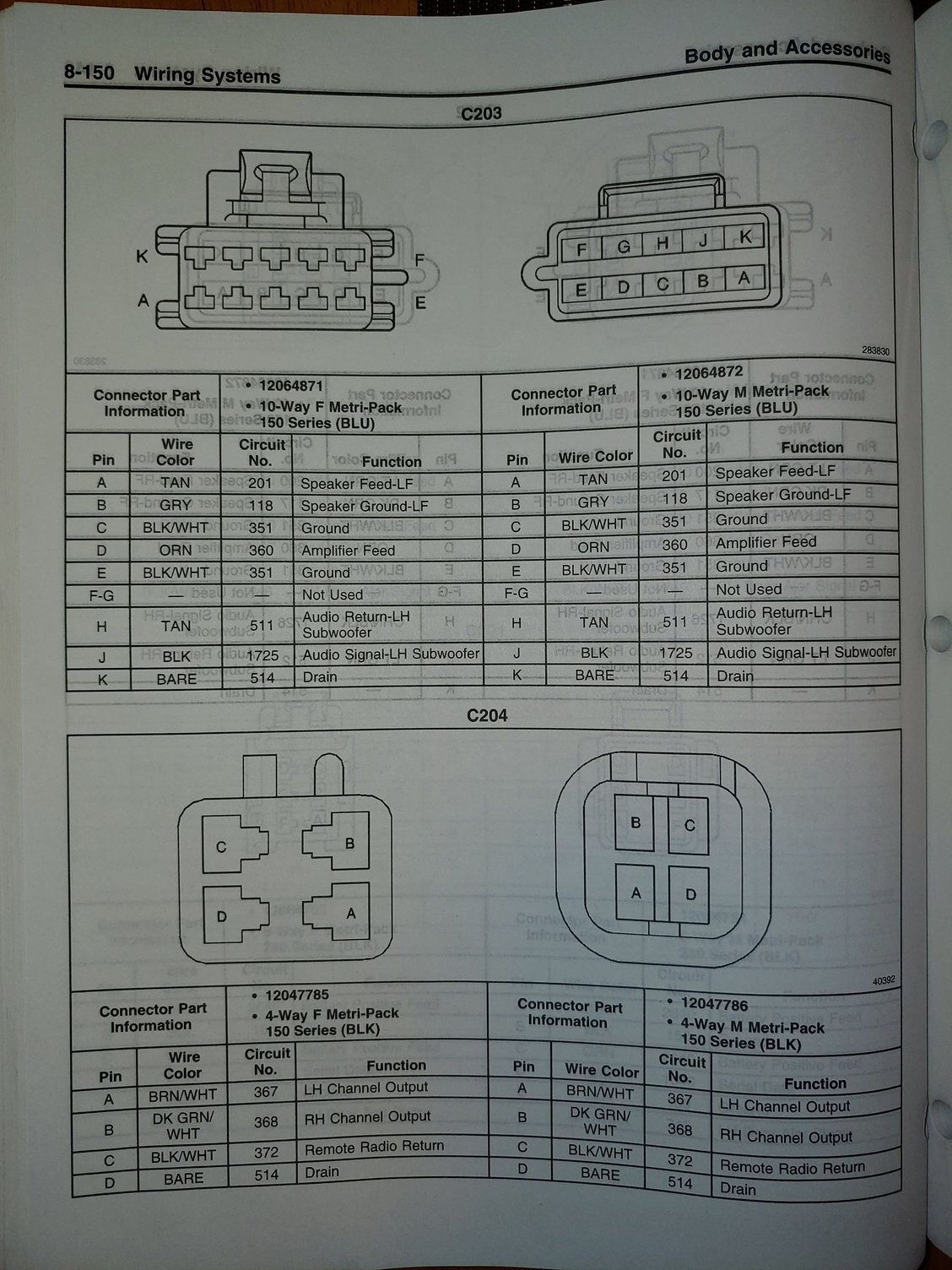

The blue connector is for speakers only.
The bare wire is normal. It's a drain for the Bose system.
The black connector is power, ground, and serial data for everything else in the door.
C203 is the blue connector driver side.
C201 is the black connector driver side.
Ignore C204

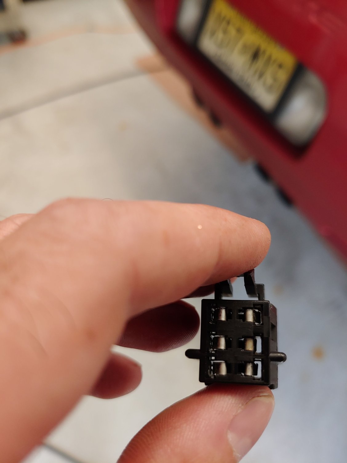

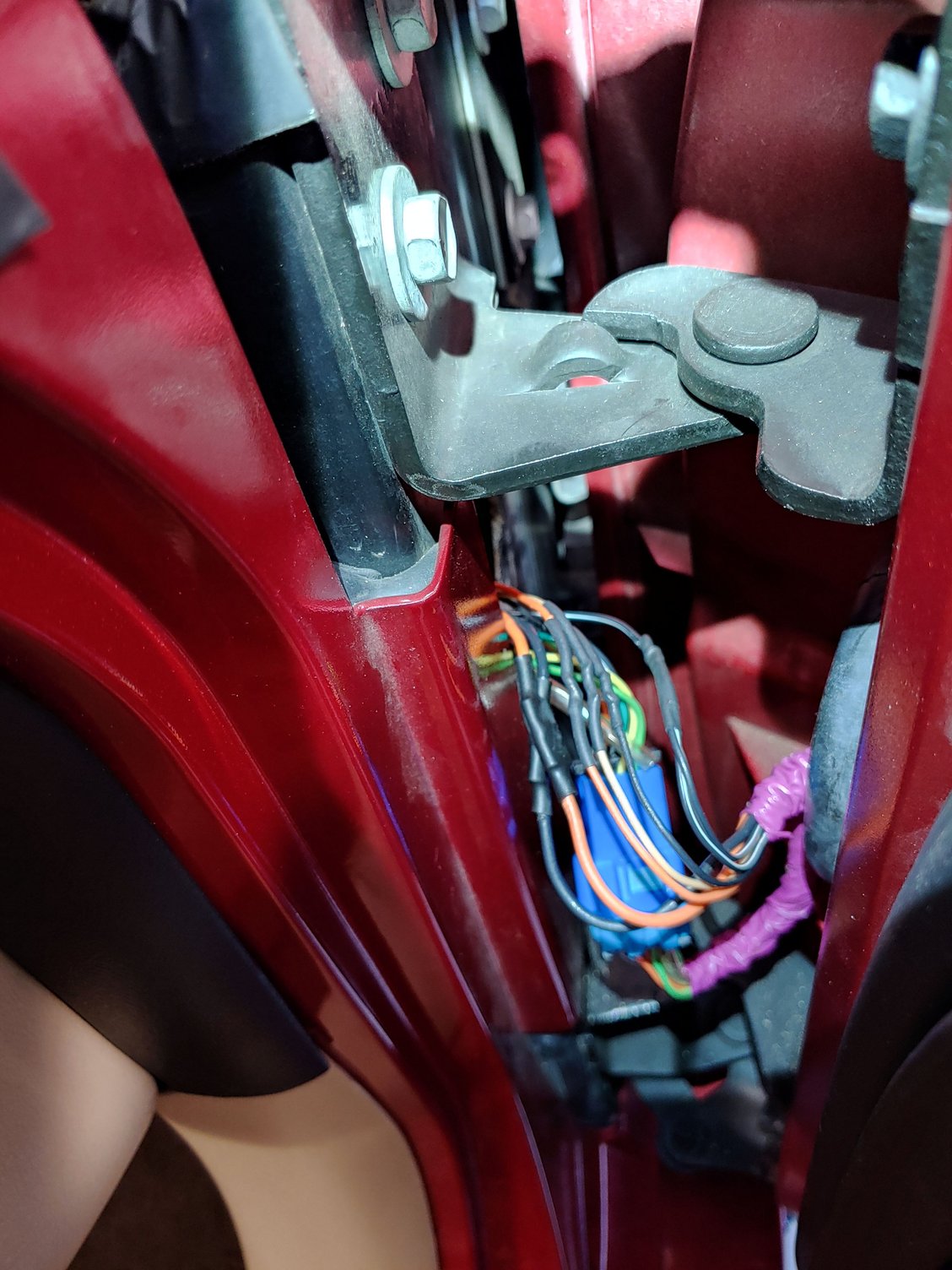

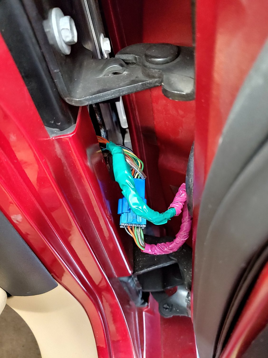

You can bend the terminals back into shape, or replace them, if you wish. I chose to remove the connector so the problem never comes back. Those connectors are there so the factory can fully build the door and test it on a work bench, then bring it to the car on the line and install it.
The problem.
Solder and heat shrink the 6 wires and eliminate the black connector. I was able to work the accordion over the wires and completely into the door, giving myself room to work.
Wrap with tape and pull the accordion out of the door. Permanent fix.
