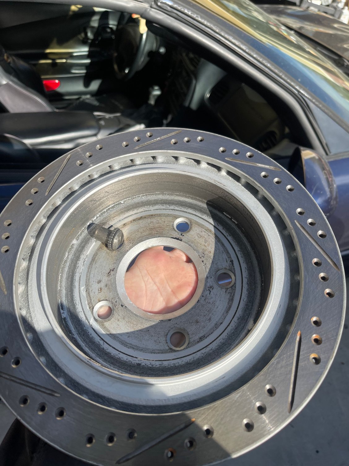

hi guys c5 has been giving me problems recently. After replacing rear wheel hubs/bearings, lower ball joint, and new rotors/pads, I still have this noise that I can’t figure out. Video is attached to show underneath the car while it’s driving, so you can hear the dragging noise. (Nothing is actually dragging) this is my daily and any suggestions are appreciated.

Mostly what stands out to me is this sounds like something small hitting something thin. Could there be something inside of the muffler moving around? Do you have to be moving or just have exhaust gases flowing?
Another thought is something inside the tire/wheel banging around. Sounds too sharp of a clunking sound to be a denser material like a rim barrel being struck by a loose object inside a tire.
Of course hearing it on my speakers could sound a lot different in person. If it seems left or right you could reverse the rear wheels for a test.

You mentioned the wheel and I took it apart, found the culprit lol it was a bolt from the ebrake assembly rolling around in the rotor… I thought it would be a lot worse!

turns out it was a little bolt rolling around in the rotor!

Nice find. A rather unusual cause of the noise.
