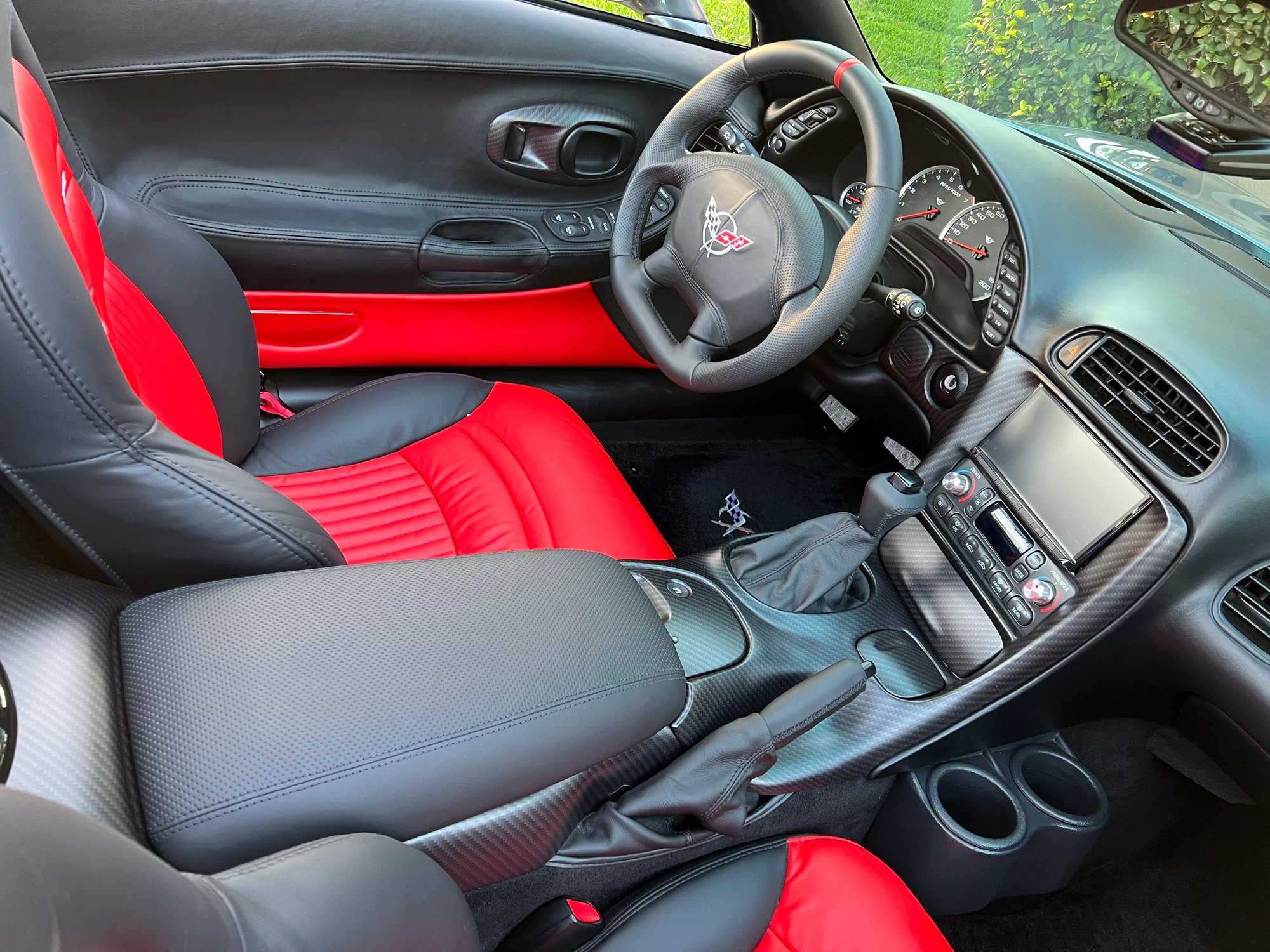

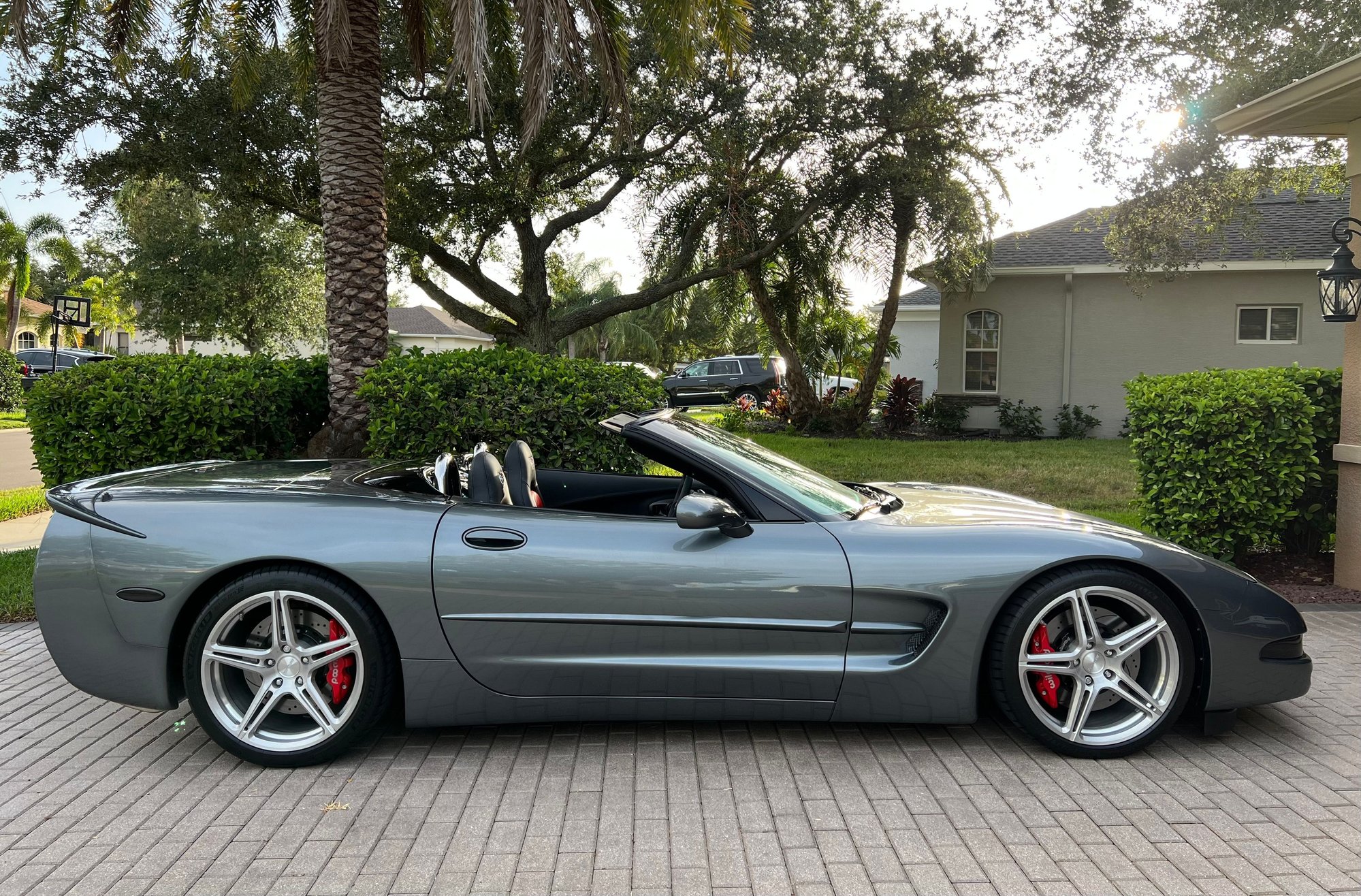

Thanks for the feedback. I also want the sleeper look as I want to keep my 2004 convertible stock-like in appearance. It's only when you get closer to the car that you realize it's not stock and that it has many performance and cosmetic upgrades. I didn't want to refinish my center console (again) to accommodate gauges, plus if I did choose to add them, I would want them eye level. Even though the gauges on the A-pillar are eye level, they definitely offer up a "Boy Racer" look which is not what I'm going for. Glad they aren't really needed with the new A&A kit.

She’s a beauty. Soon she will be a bratty beauty that boogies! I also feel the A-pillar pods are a bit “boy-racer” but truth be told I still think they look cool. But once confirmed, by Chris, the gauges aren’t needed…made my decision to forego them very easy.
My car looks really stock with the exception of being lowered on stock bolts and the trackspec vented hood. Which was added for heat dissipation. I also have the stock hood hanging in my garage. So I didn’t need to hack up my original one. I even stayed with OEM factory painted thin spokes, and left the BSM on the side of the car. As long as my car isn’t running, parked with the hood popped, or it’s just cruising in 6th, you can't really tell it’s H/C/FI. It’s purposely pretty “basic” aesthetically.
It does have Borla pipes out the back but aftermarket exhaust is typical on most of them. I do have a mounted Raptor shift light on the pillar. Oh, and I swap between a C6 shift **** and a Raceseng Signa-Ture **** from time to time in place of the OEM ****. That’s about it for cosmetics.
So she’s “sleeper-ish” sans the hood and entire drive train.
