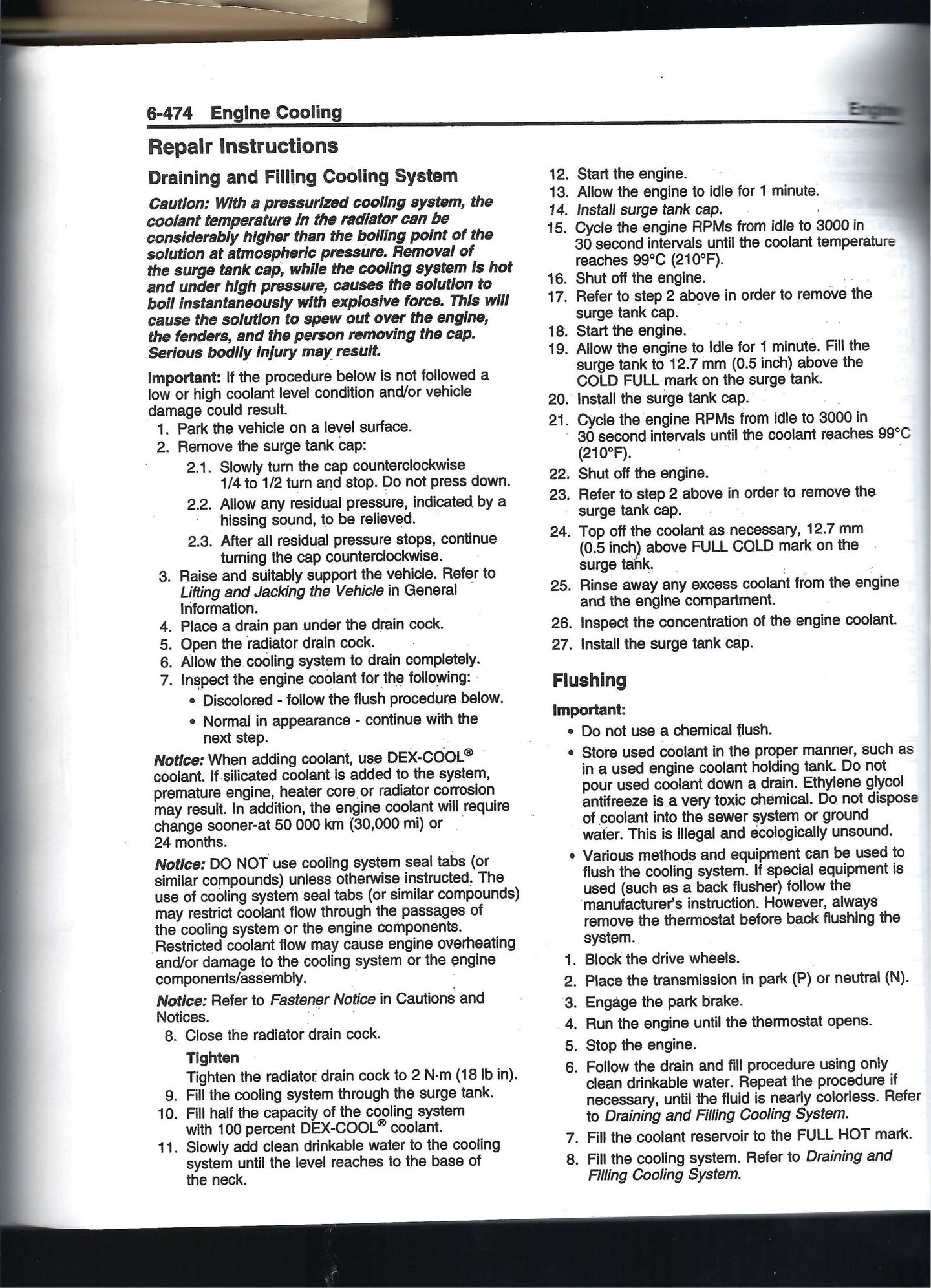

A frequent cause of overheating is after the cooling system has been opened or drained for any reason is that air is still trapped in the heads.
Here is the Factory Service Manual procedure to remove trapped air from the heads:
If all else doesn't solve it, then that would be a serious amount of air in the system. I had the car burped multiple times by mechanics prior to me dropping it off a month ago to see if it would solve the heating issue. Only thing I can assume is they were doing it all wrong.
