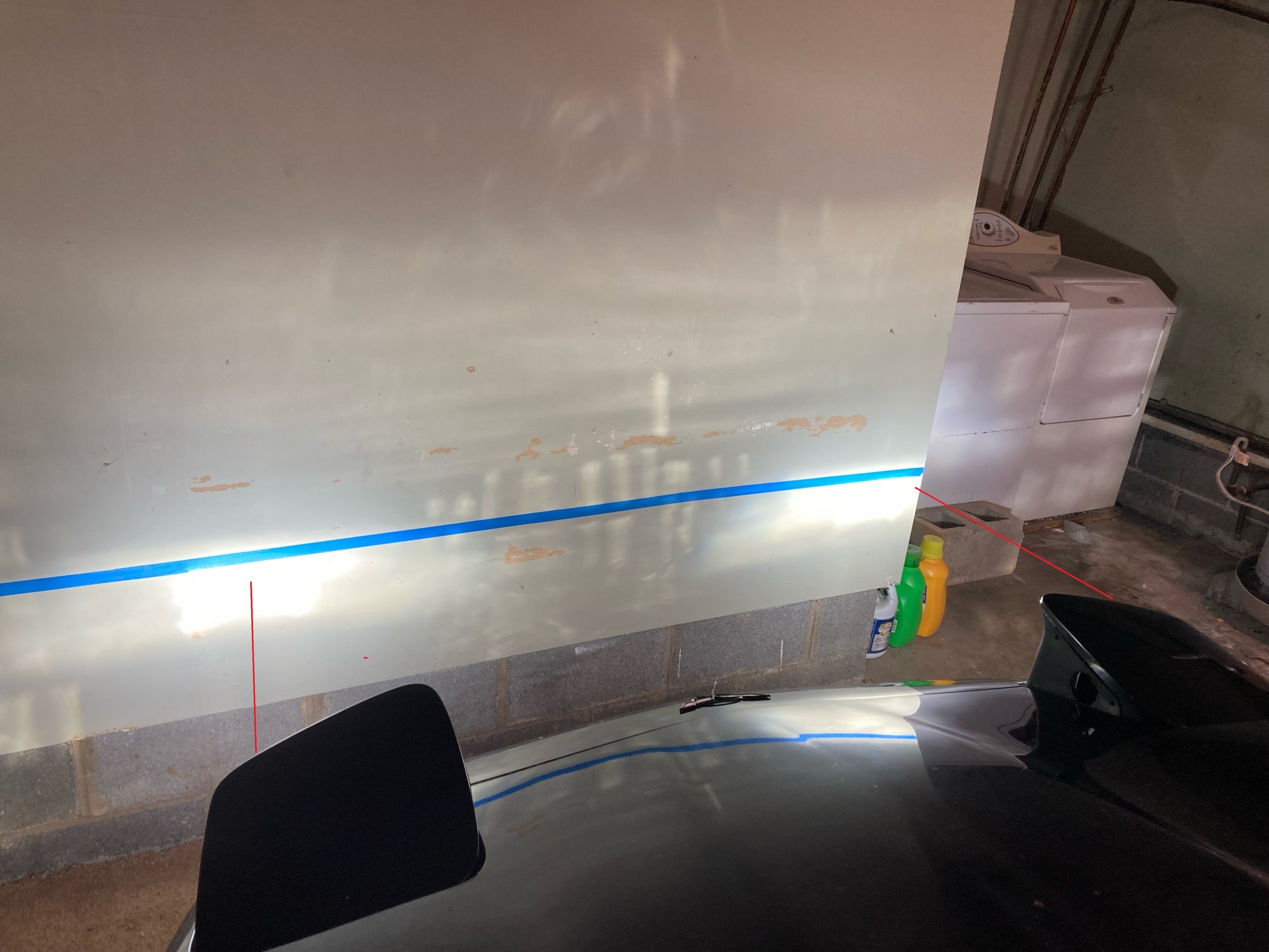

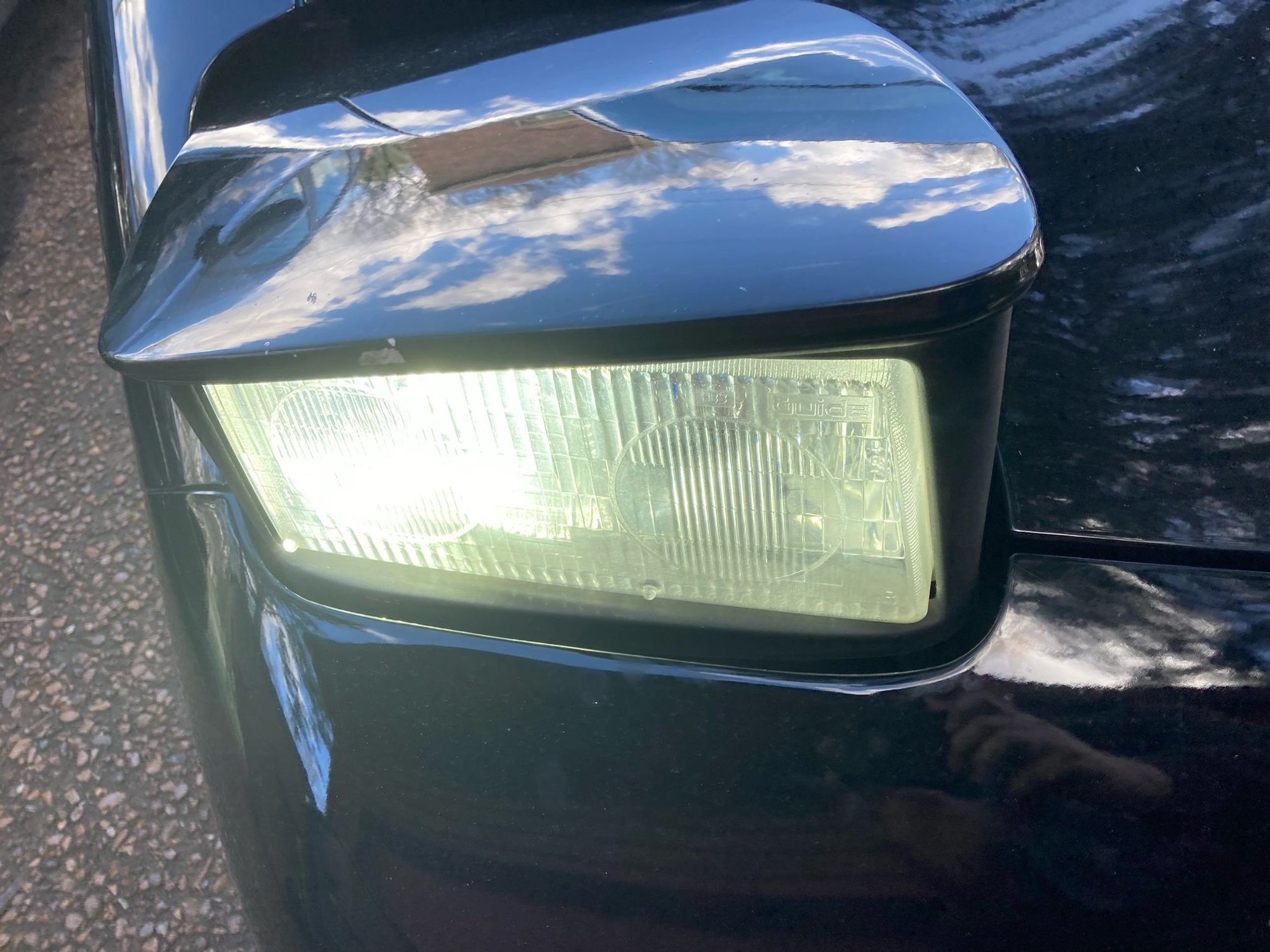

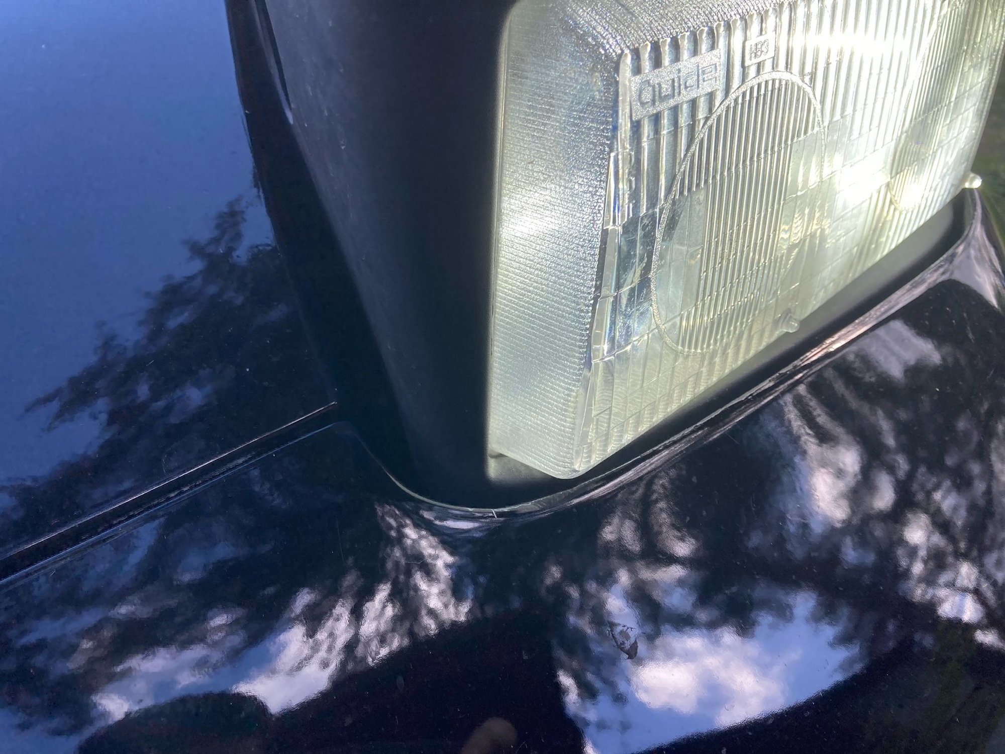

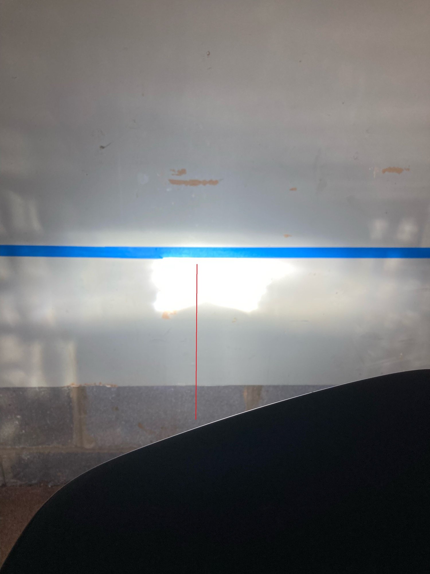

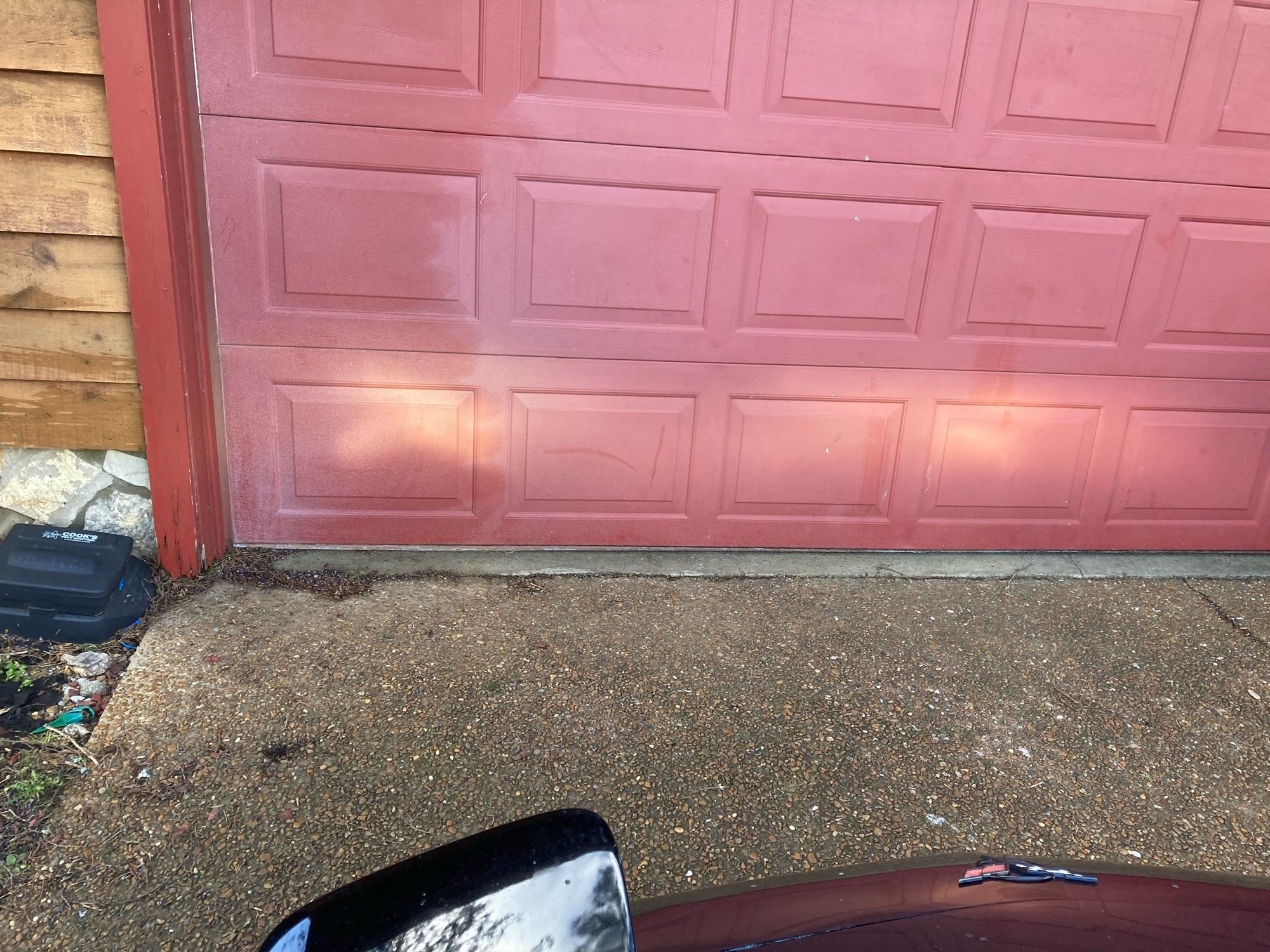

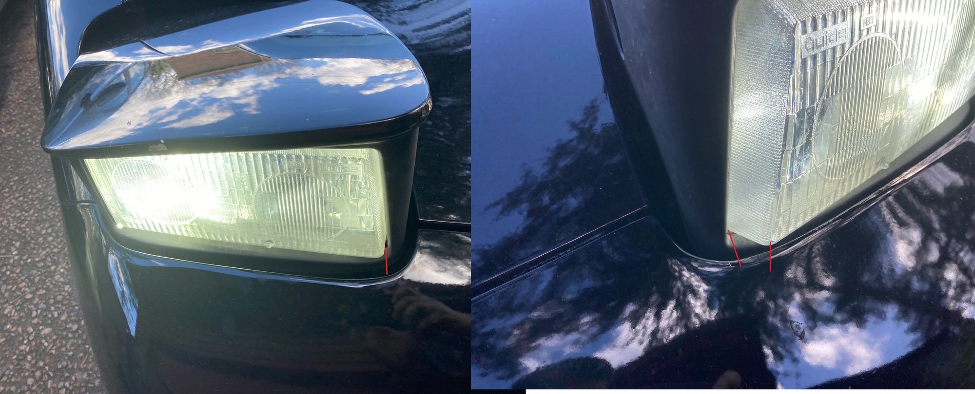

When I pull right up next to the wall and look at my headlights only this look even. By that I mean the hotspot is directly inline with the left headlight low beam center, but to do that I have to make it come out farther than the plastic molding. Is this not the proper way to center the left headlight? If you look at the right headlight it is flush and easy for the headlight to retract. Whereas on the left headlight it must hit the molding to lower and push down on the plastic bevel slightly. Should the hotspot be directly centered to the headlight when right up close to a wall.

Here is what it looks like up against the wall. I was told to align the headlights up against the wall first, then align the horizontal 25 feet back. Is this not how it's done for the c5?
It seems odd that my headlight has to actually pop out past the molding just to be aligned up against the wall. As always thank you for all of your help.

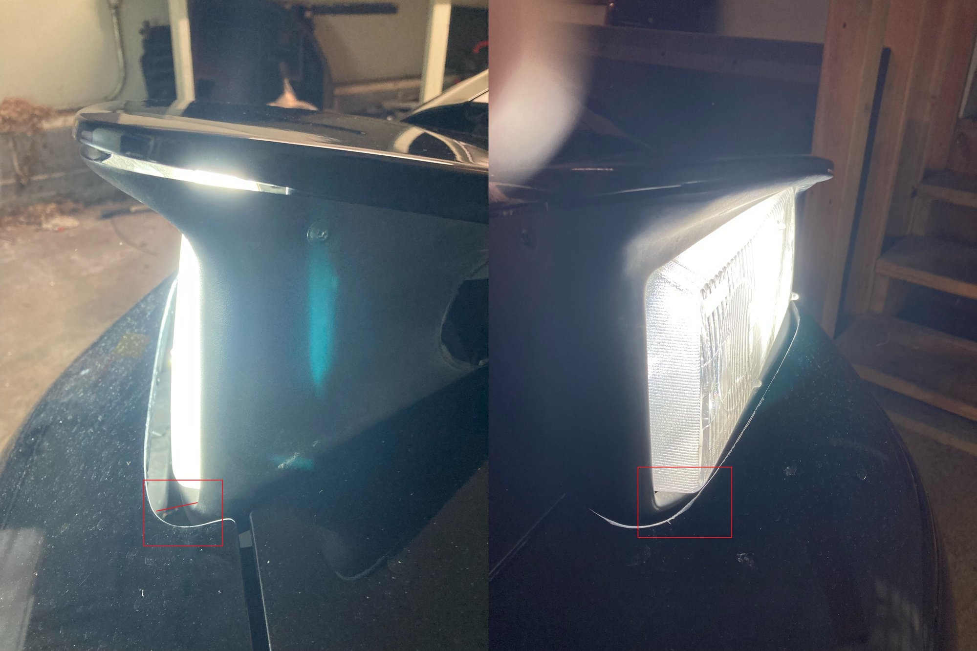

Also I have attached another video to allow you to hear what the driver's side headlight is doing better even after a new headlight motor. I will go back and fix the headlight bevel on the right side too.
