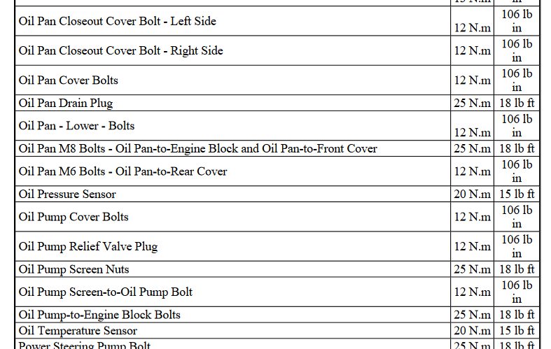

Double check that torque value. I show 106 lb in (for some- others are 18 lb ft) which is just under nine lb ft.
This is a screenshot from the downloadable manual that is stickied here and indicates it is for a 2004. My printed manual for a 2000 also says 106 lb in.
The bolts he's mentioning are the upper m8x1.25. The torque spec for these bolts is 18 lb/ft.

He posted 106 lb/in - I've interacted w/ him in the past and he's a good guy. But that's the torque spec for the m6x1.0 bolts (the two rear in the upper, and all the batwing bolts). I just finished doing this job <click myself. It's a "peach", but not as bad as pulling the driveline (3-4 times)!
