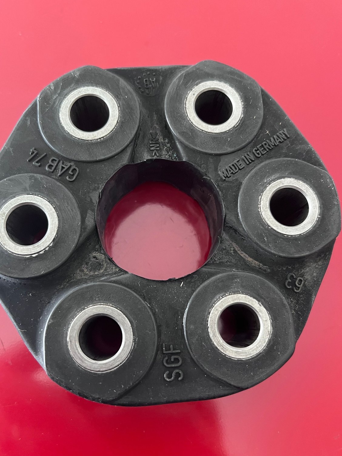

Here is the coupler(s) I got from RPM. German anyway. It’s just a stock Z so I’m guessing these should be sufficient. Also considering a LUK clutch assembly. Any thoughts?

Couplers look exactly right.

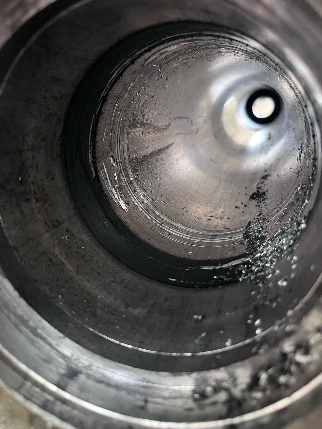

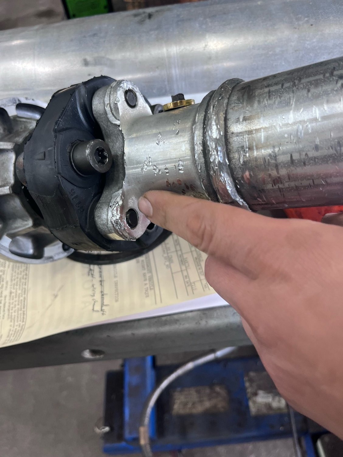

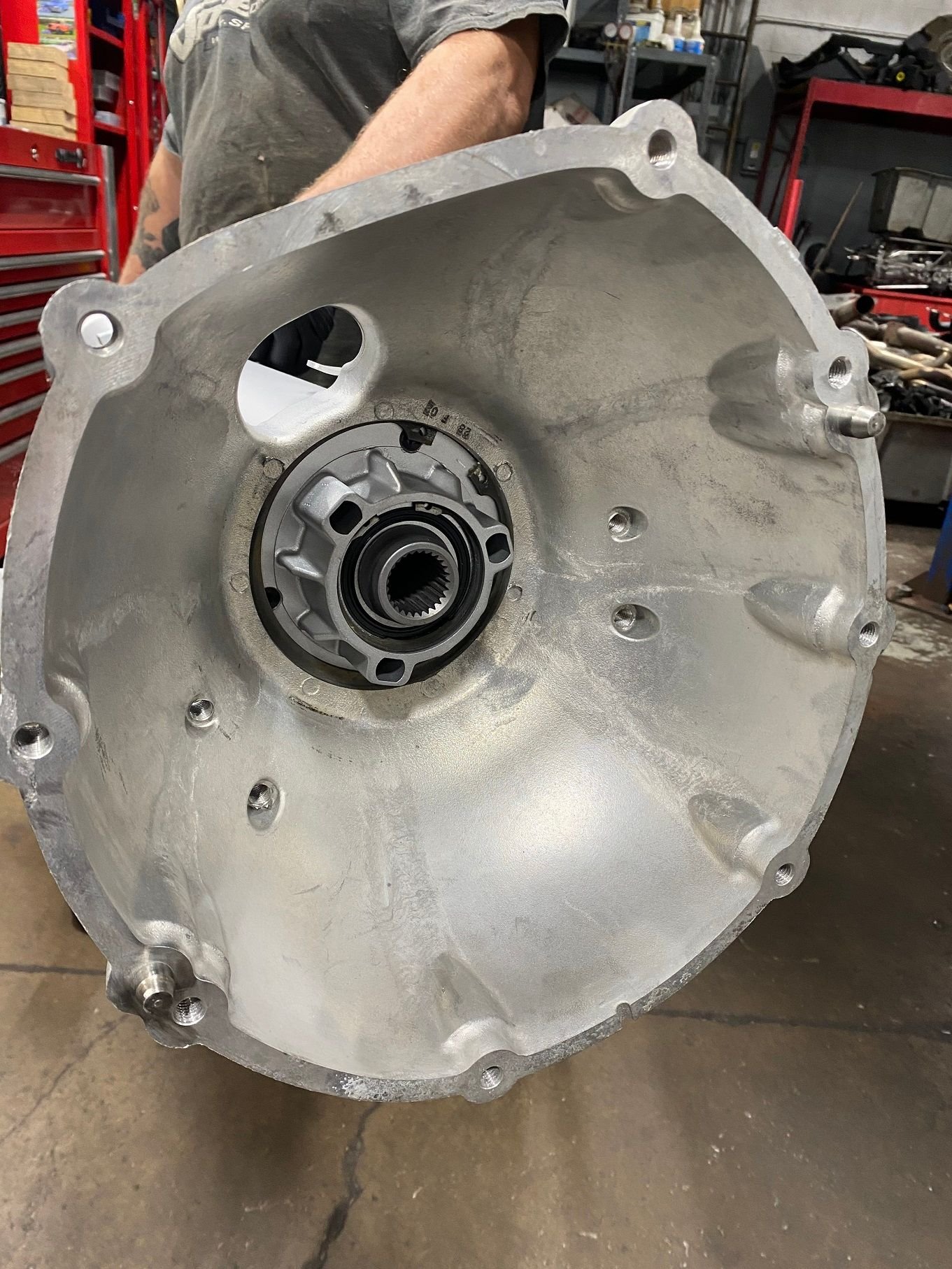

So a friend asked how I could have possibly hurt a coupler on a stock Z06. Well, I didn't as it turns out. One of the bolts in the coupler to the drive shaft worked itself loose and went for a ride in the torque tube. Drive shaft doesn't look good, tube is a bit rugged as well. The tech doing the tear down pointed out there was no sign of Loctite on the bolt which should have been used. Took a few pictures for you guys. Vibration and rattle now finally explained. I went ahead and sent a heads up to the shop that assembled it 4 years ago though I'm not expecting anything.
