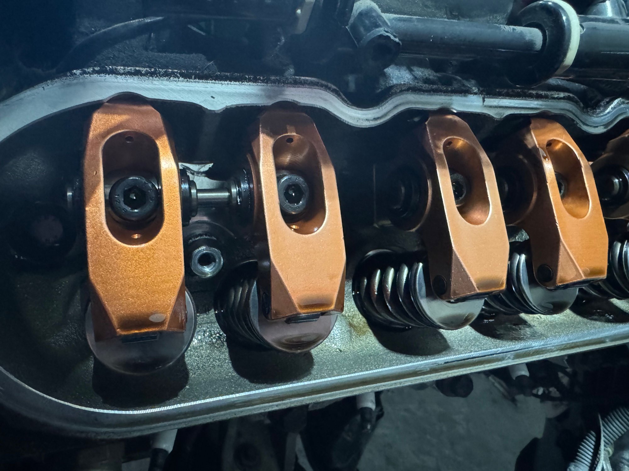

Anyone know what brand these are?

Yella Terra, maybe.......

Harland Sharpe rockers? They are the right color and shape.

Thanks for the info. I’m assuming because they are roller style they tend to be a little louder than stock? Have been hearing a ticking and have no leaks anywhere, I’m replacing the valve cover gasket and grommets. Car runs perfect no codes. Just seemed a little louder than my buddy’s stock c5.

Might check the adjustment as they really should not be making noise. They should all sound even and like a sewing machine with the covers off.
Any ticking or odd noises should be investigated. If you can narrow the sound to a rocker pull it off and check the rollers as bearings go bad at times. HS rockers are a value brand so they are not top dollar.
Make sure the springs are not binding or there is some geometry issue with the valve train. Could be wrong push rods too.
Hard to call just from a web post but that is what you can check for.

Not yella terra. Does look like harland sharp. No they shouldn’t be any louder than stock just because they have a roller tip

Harland Sharp, i have those on my heads
