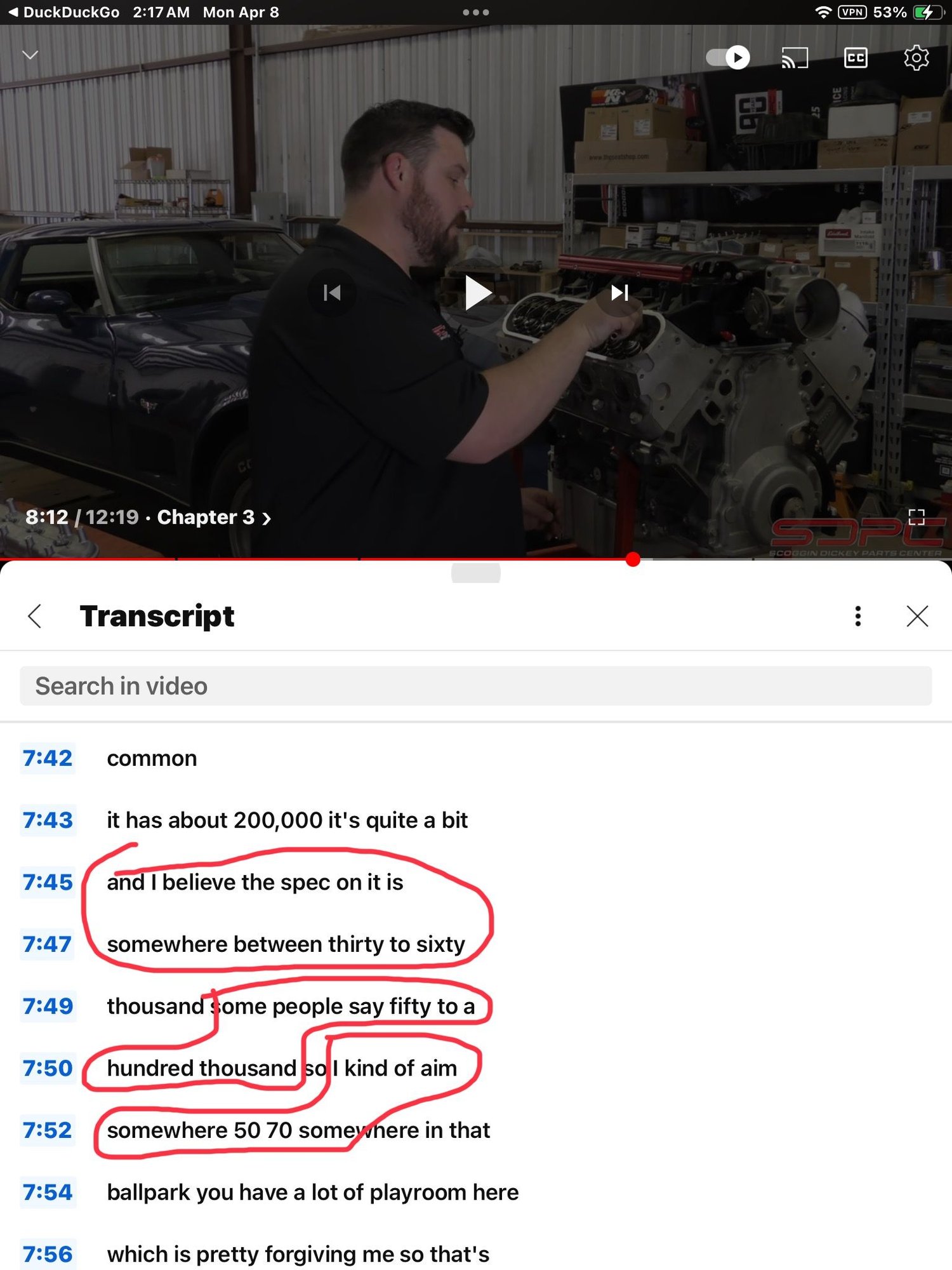

Below is a snapshot from the SDPC tech guy who is measuring pushrods for pre load. Now this guy should know what the correct preload is, within a range. He works for a GM parts distributor and does tech videos on their behalf…
Here he states the GM spec is .030-.060, then says some people say .050-.100, so he aims for .050-.070. He doesn’t explain why he is not using the manufacturer (GM) spec.
Now, I’m not picking on this one guy, rather that this is typical of the videos, posts, and articles out there. It’s the preload dartboard.
What preload do you use?

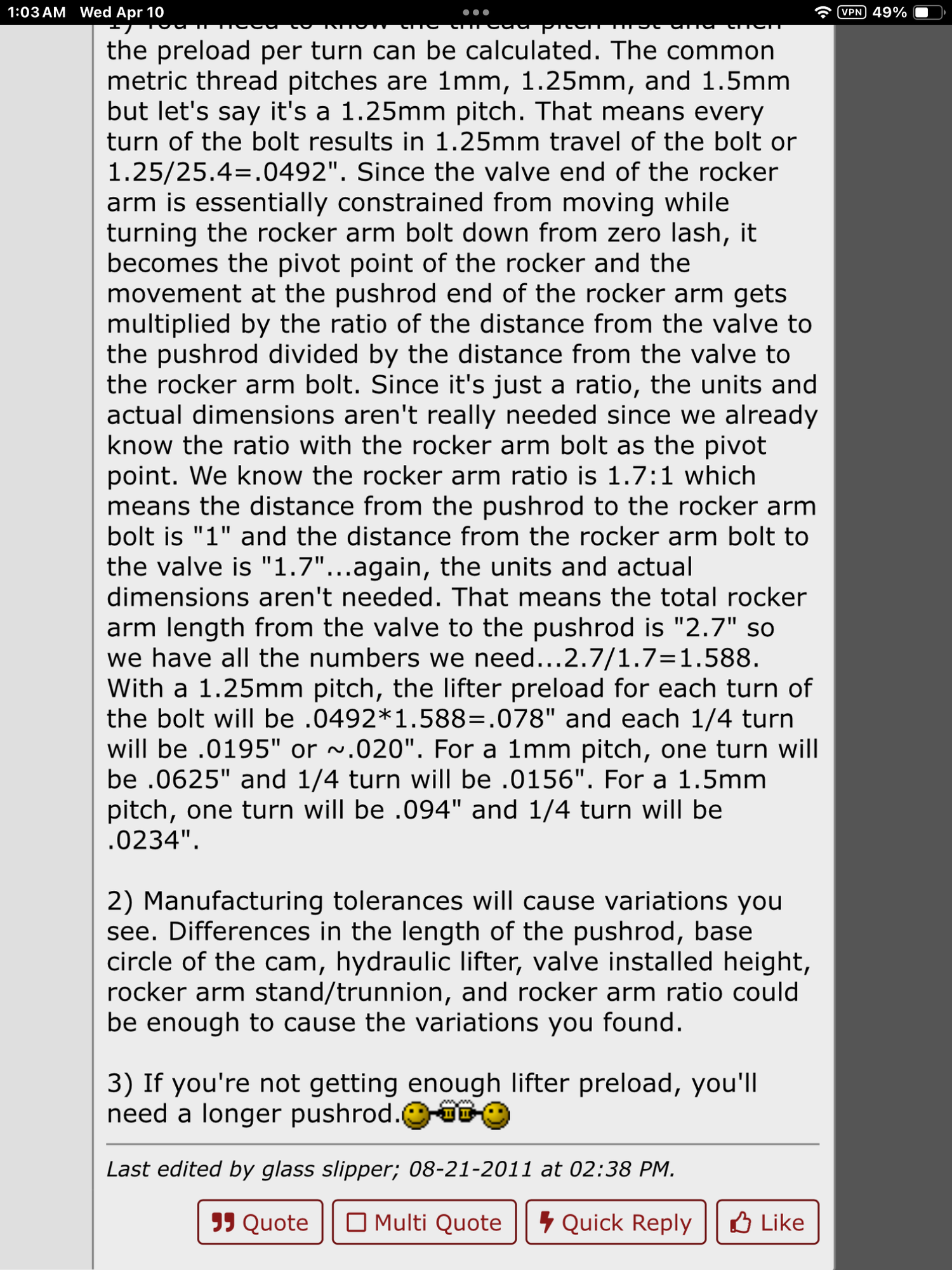

Interesting post on turn method calculation…
https://www.corvetteforum.com/forums...post1578473349
