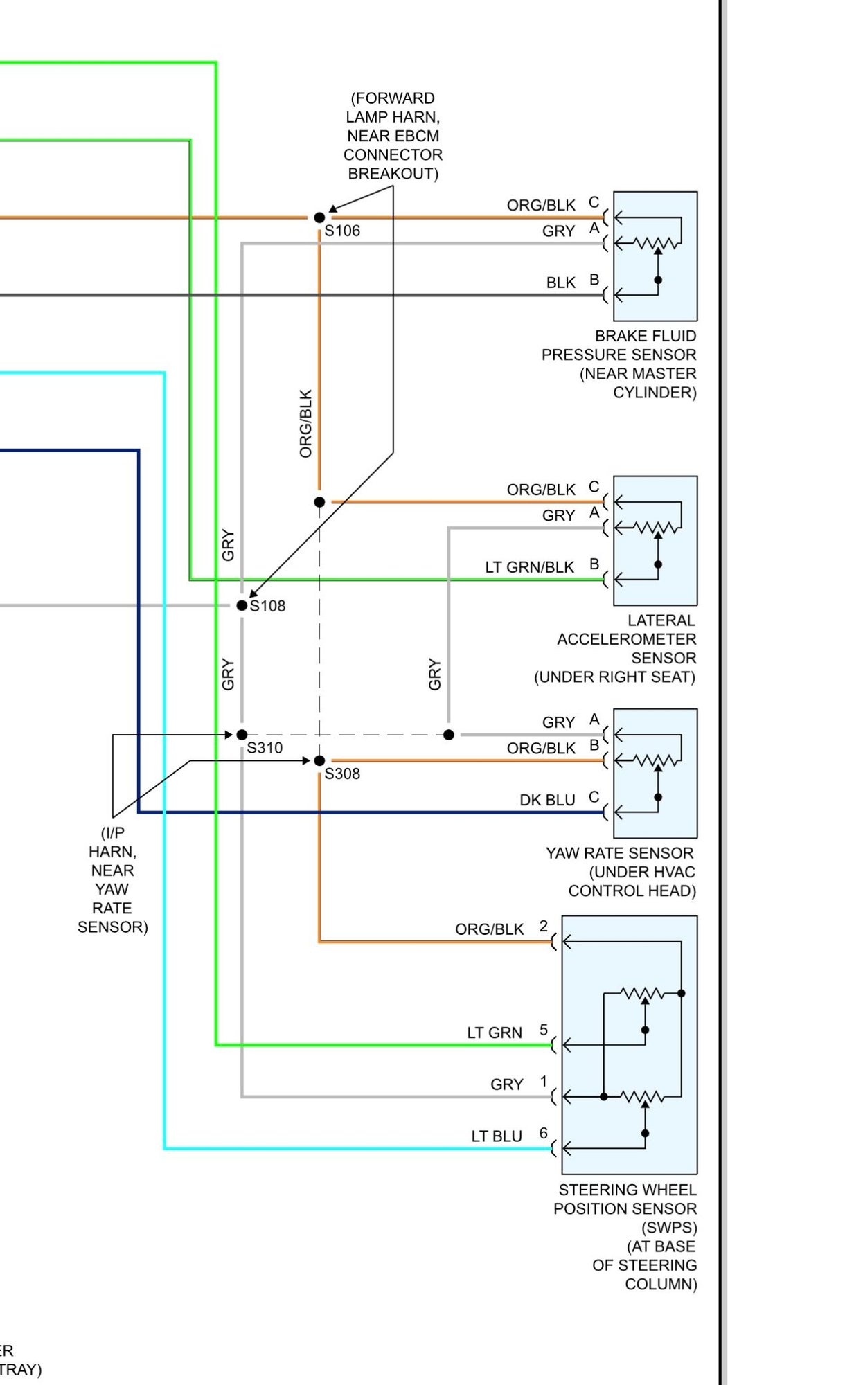

Cage builder had my dash out and now that it us back in, the steering sensor does not work.
I am trying to get the stability control back online. ABS and Traction Control are working,
No wires are (supposed to have been) cut durng the cage installation but many harnesses are unplugged to get the dash out to weld in the dash and down bars.
I am getting Codes C1287 and C1288. The Autel scanner reports NO output at all from the steering sensor.
Do not think the steering sensor is bad because the sensor is plugged in - but the plug at the sensor does not have 5V in (tested with meter).
I also have verified that the Yaw SensLateral Sensor, and Brake Sensors all have 5 V in.

If you are not seeing the 5 volt at the Steering Wheel Position Sensor but you ARE at the Brake and Yaw sensor you will have to check the wiring downstream of Splice (S310) which as you can see in the wiring diagram is near the Yaw Rate Sensor…the 5 volts comes from the EBCM at S108 then branches off to the other sensors on the Gray wire.

This is what I'm looking for!
