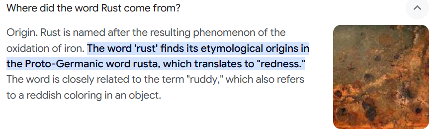

Originally Posted by Kingtal0n
I consider the chemical processes which cause iron to oxidize also cause aluminum to oxidize the same process
Agreed on the statement above....past that, your wordy response is not correct, even with .."The Craftsman Blog" as a reference. By definition, chemical composition, engineering definition, etc.........aluminum does not rust. Rust is associated with Iron.
Kellanne Conway's 'alternate facts' does not apply here.
