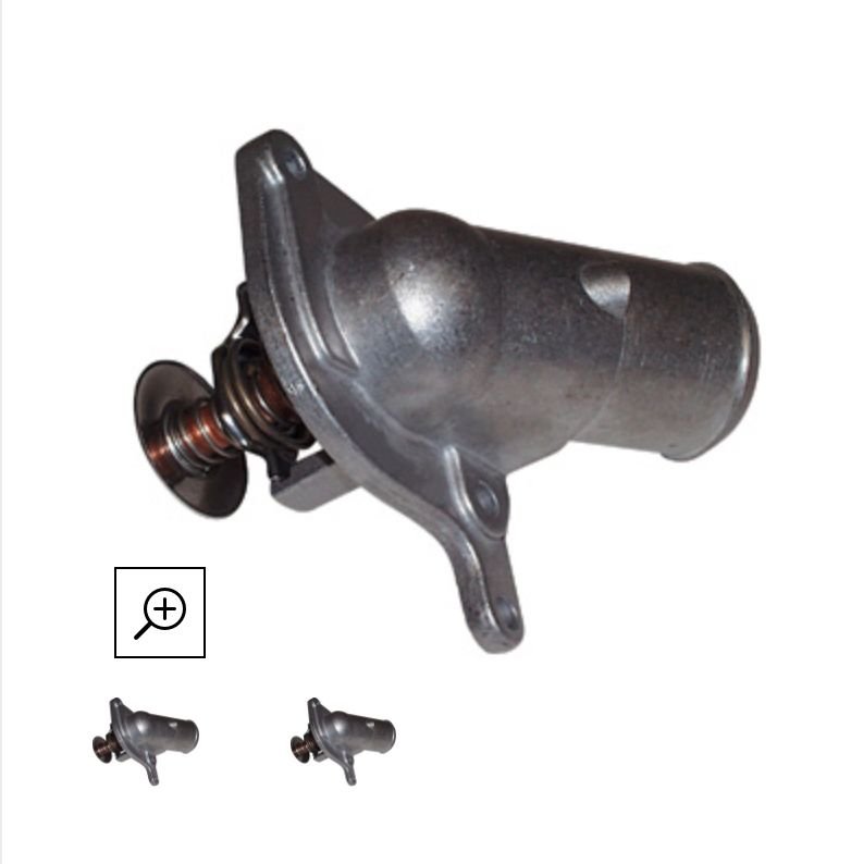

Below is a pic of my housing, and the image on the Lingenfelter looks way different to me.
Lingenfelter

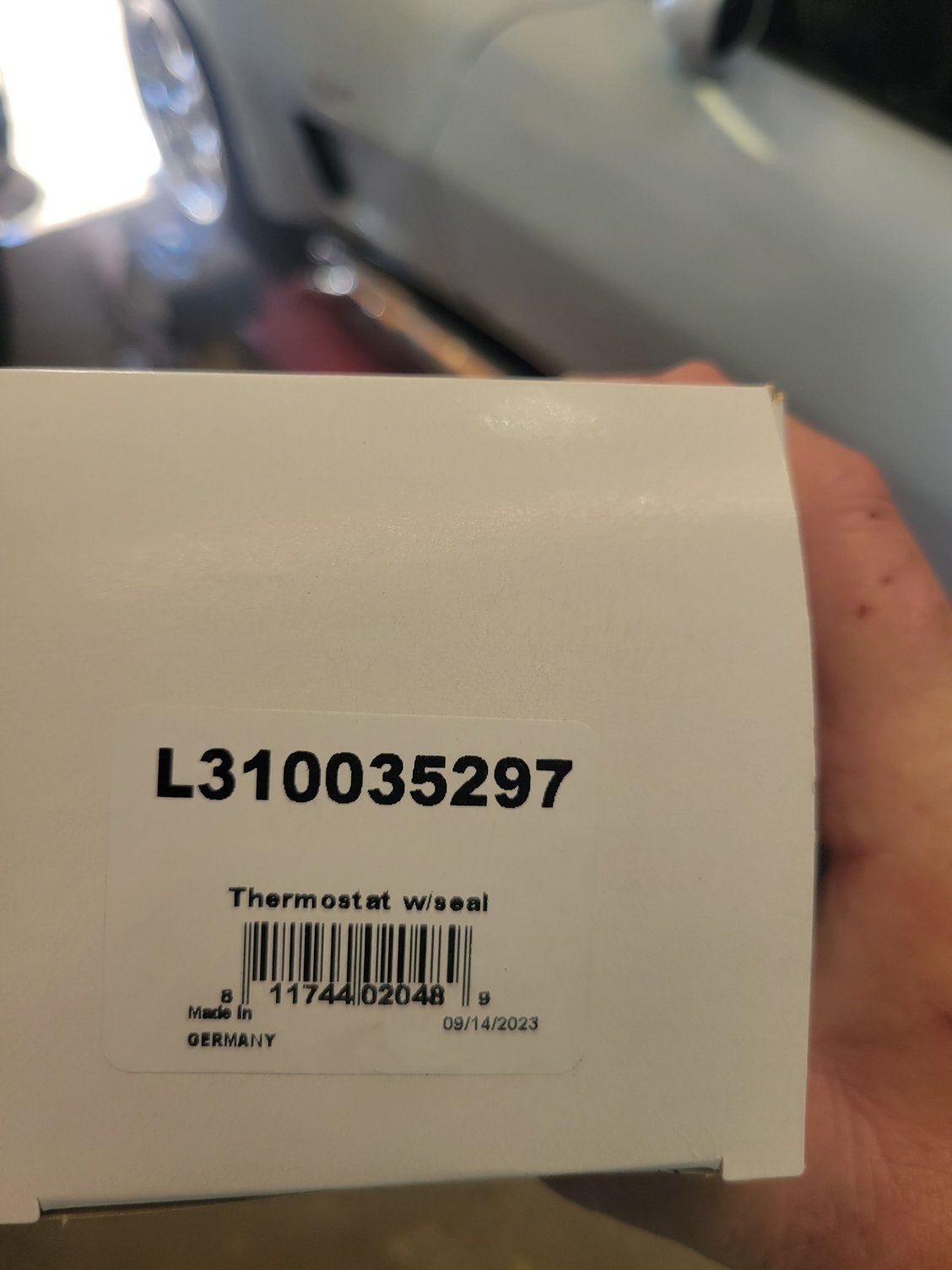

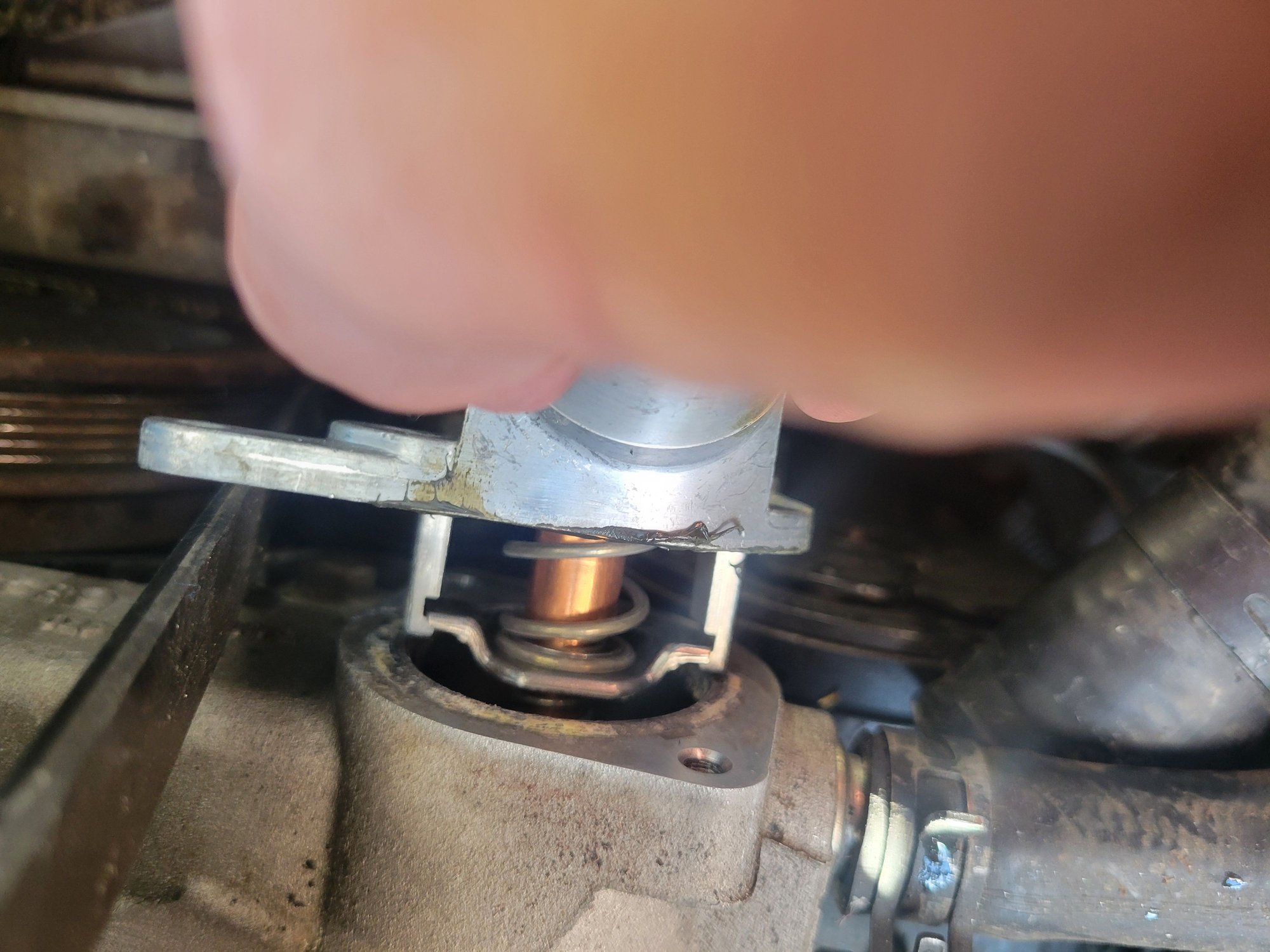

So update today I overnighted one that is suppose to fit in oem housing .

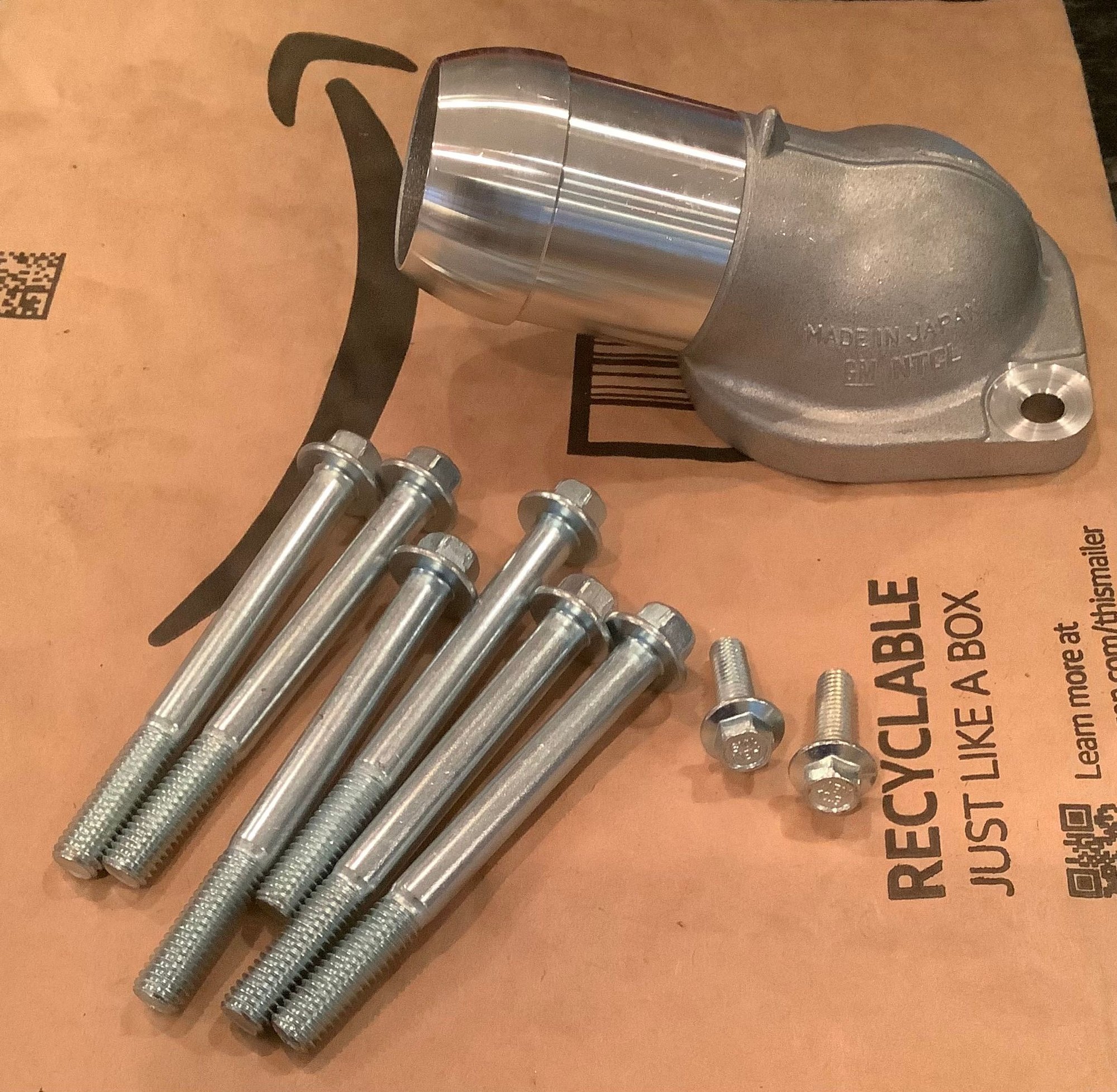

Here is pic of the ine that Lingenfelter sent me .

Ok. So I take it you are not the original owner and/or the water pump was previously replaced.
Looks like you have a 2004+ LS1 / LS2 water pump. They changed the from a one piece housing/thermostat (like the one you ordered) to a two piece. Looks like the opening was reduced as well, which is why the 97-2003 one piece assembly does not fit your water pump.

Pretty sure that is for a Allison-Chalmers D47 combine.
