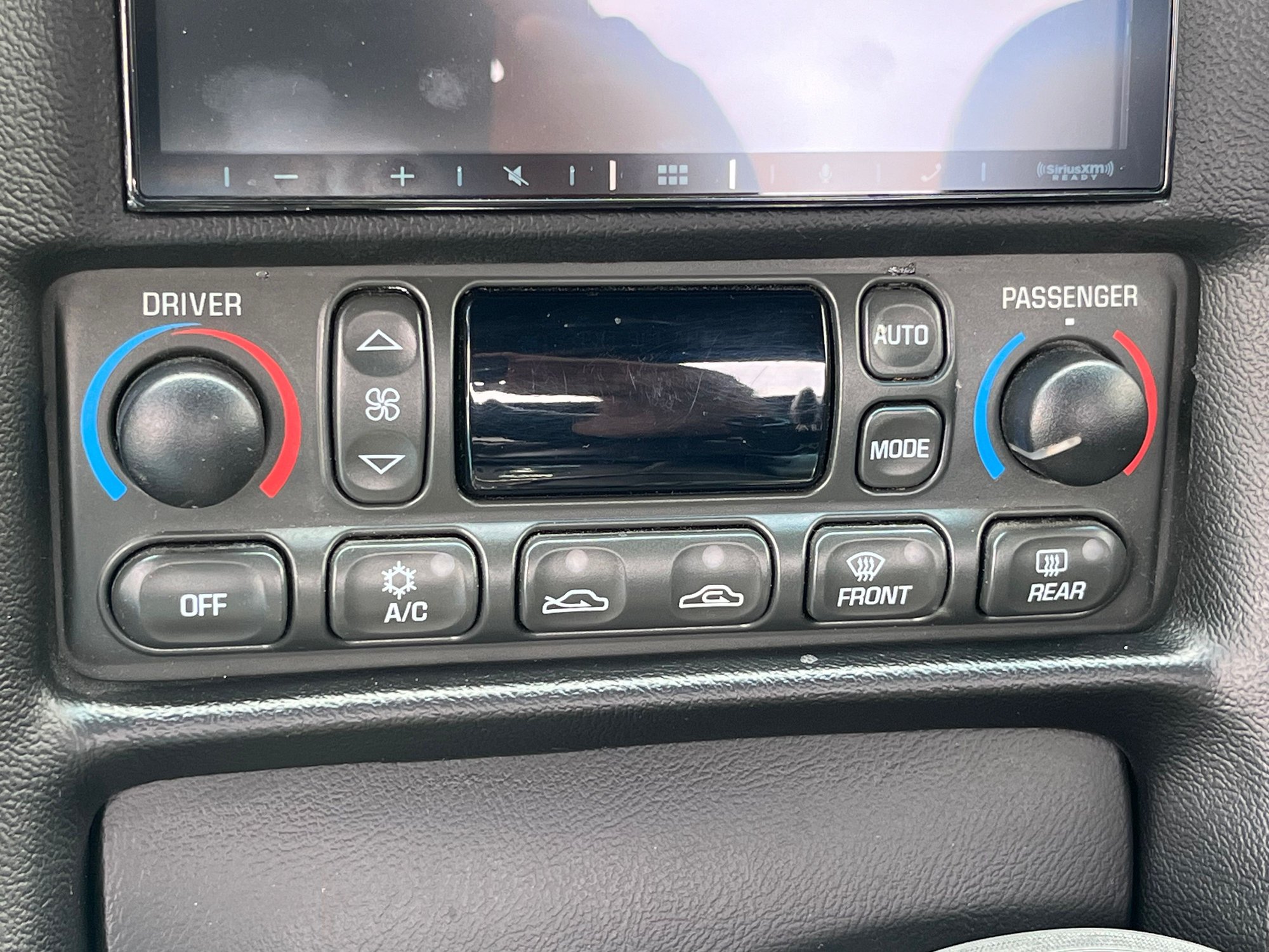

What should we gleam from this picture? Is the car running with the A/C on and the display is not working? Which **** are you referring to?
Im just showing the unit I have in the car. The temp control **** is the issue. It doesn’t adjust properly when I turn the ****.
