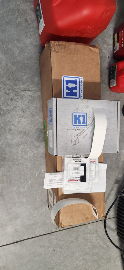

Update for tracking purposes. Heads went back to the machine shop to shave a little more off the bottom due to piston size to achieve desired compression.
Block is getting final hone next week.
Crank and other bottom end stuff is in the garage waiting for next step.
