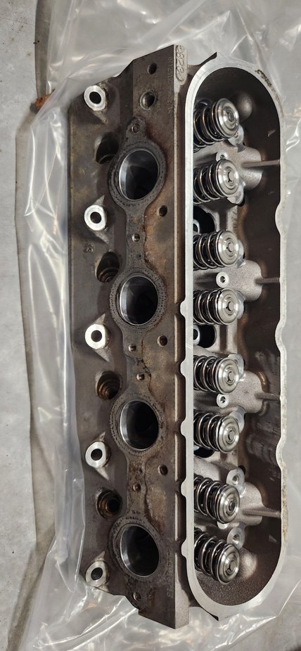

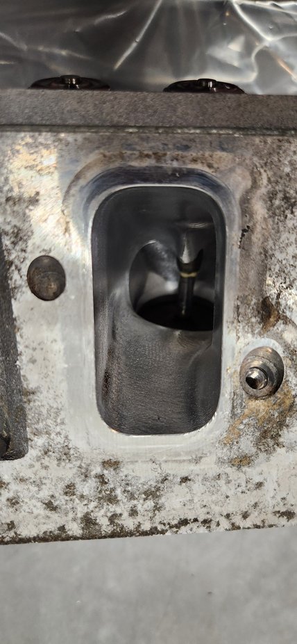

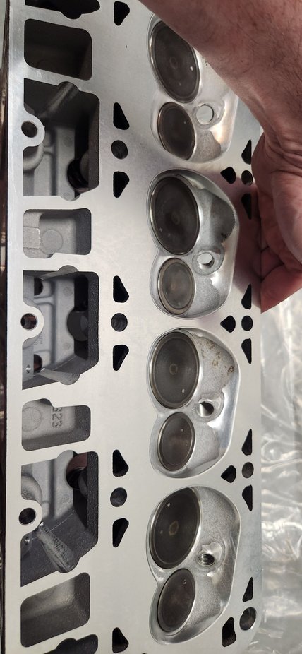

Hello all,
I'm in the beginning stages of putting together an LS3 based 416 for my 04 Z. I figured I'd document it and also seek guidance/recommendations along the way. Car is solid as-is but I recently sold my s/c C6 GS and I'm missing the power - just going n/a this time. I just picked up some 823 heads and I've got a line on a LS3 block so they'll be the foundation. Not a max effort build, just a weekend bruiser that I can beat on and not feel too bad about. Next step is getting the heads squared away while I wait for the block. I'm thinking just a refresh at the machine shop with an LS3 rocker kit with trunnion upgrade. Anyone want to chime in and help guide the build?

Heads are back from the shop. Definitely excited about them and really looking forward to WHP numbers.

Do you know flow #s of your heads?
Old Jun 24, 2024 | 04:28 PM
hearno's Avatar
hearno
Joined: Mar 2018
Posts: 52
Likes: 14
They should be flowing 380ish CFM at 700 lift.

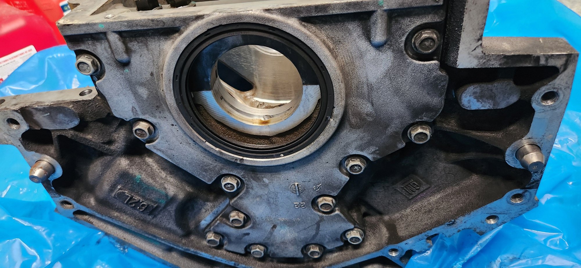

Tracking purposes, block was dropped off at the machine shop yesterday. Should be back in 2 weeks or so.
