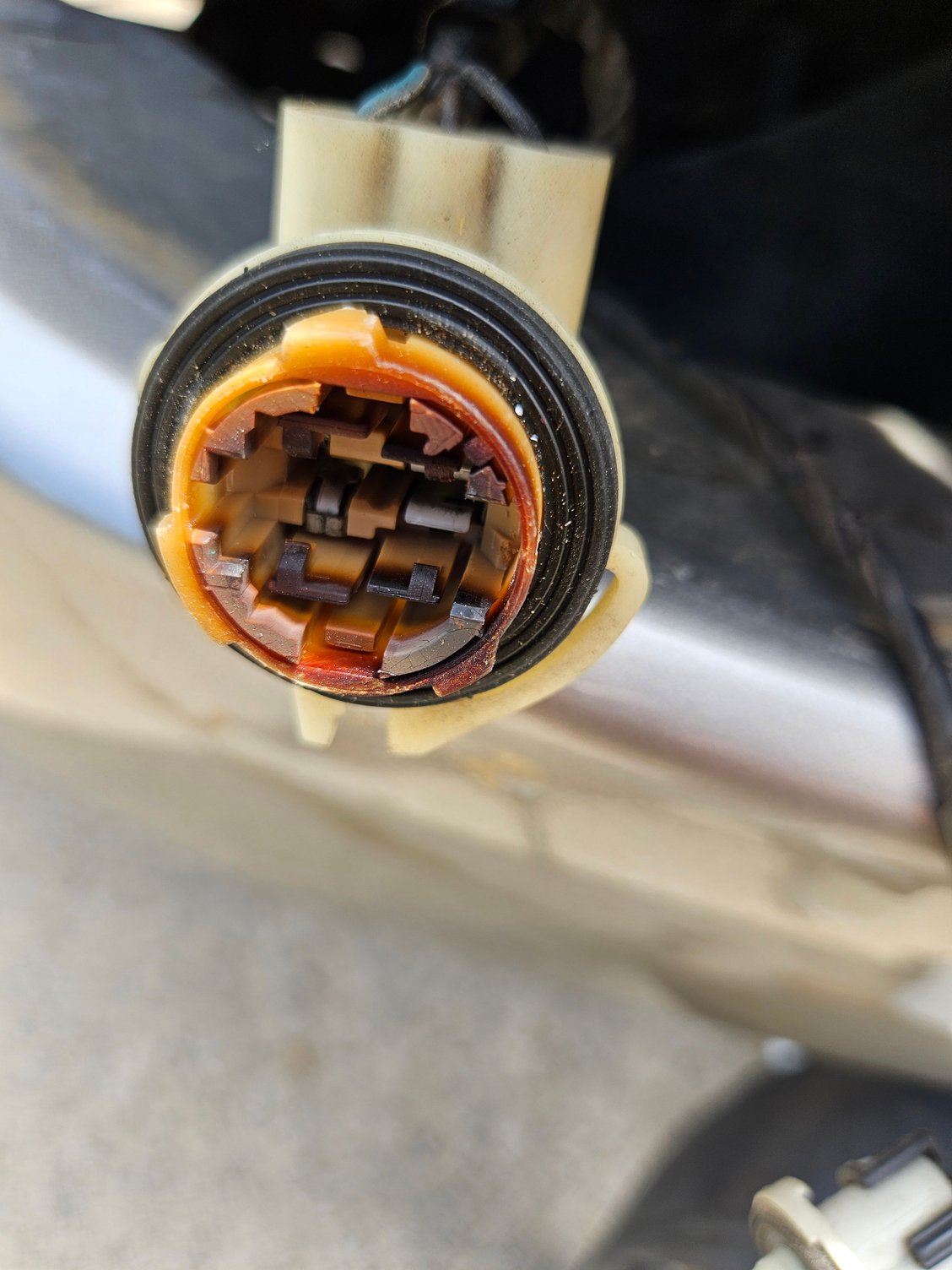

I have an issue with both sides of the car flashing quickly when I turn on the turn signal. I thought it was the front bulbs and replaced both sides but, the issue persists. I read that it could be the hazard switch but, the housing where the bulb goes in on both sides looks like this:
Could this be the actual issue, it looks like the previous bulbs melted or burned in there?

If both sides are hyper flashing, then it’s likely the hazard switch. A hyperflash harness should correct it.

Try some contact cleaner to freshen up the socket. It might be the hazard switch as you noted.
