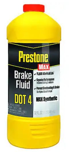

Thoughts on this? I've just recently seen "Max" on the shelves....

That product is probably fine for what you’re going to use your car for. It did not list wet boiling point
prestone dot 4
dry boiling point 505 degrees
hawk HP600
dry boiling point 575 degrees
wet boiling point 375 degrees
prestone is cheaper, go for it.
Looks like BNG (bold, new graphics) from here.
