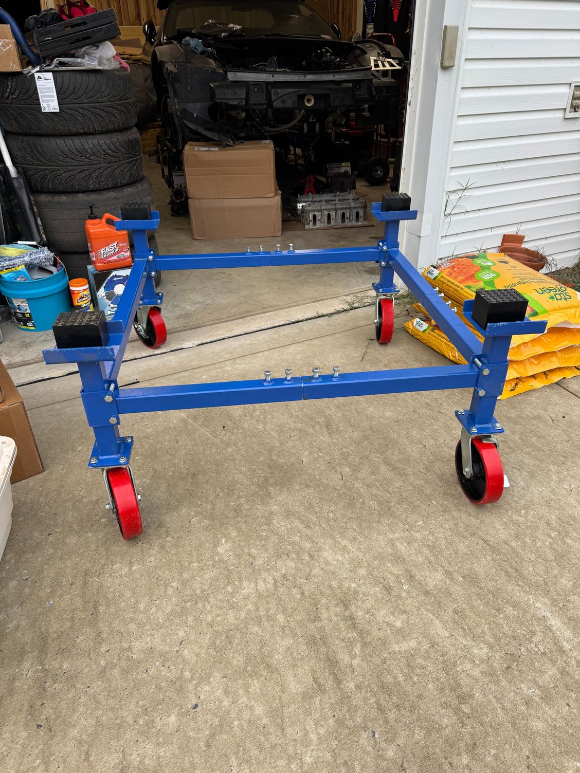

I finally got it put together.
22” tall (without the quickjack blocks)
38”-68” on each side.
Front to rear lift locations are 38” apart
Side to side lift locations are 58” apart
It supports 3,000lbs. Great for stripped down cars. Won’t support a completely stock and assembled car.
It SHOULD fit perfectly. I’ll put the car on it this week.
