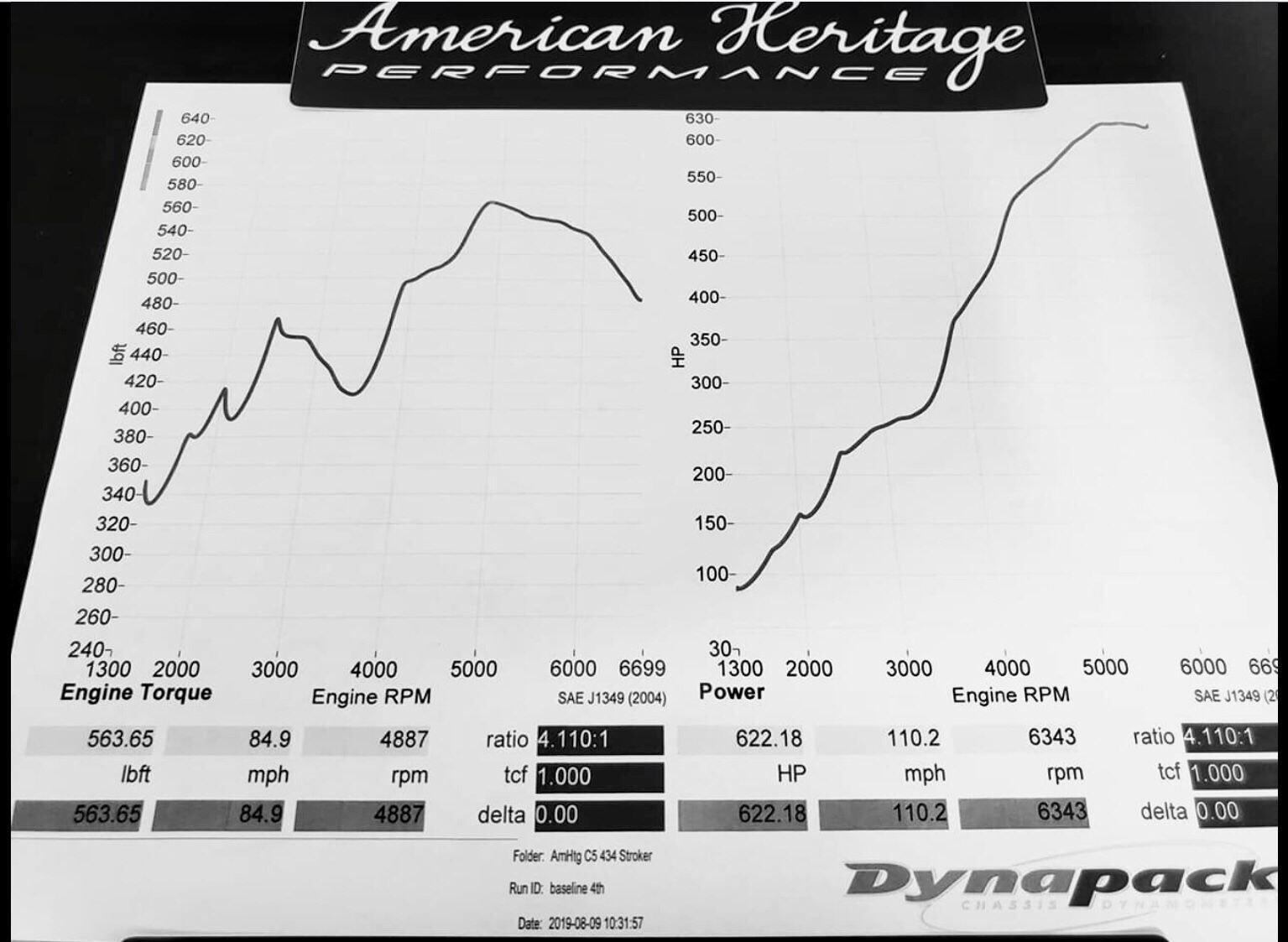

This is why I am dragging my feet plus my numbers are solid. I cannot FIT a 32 primary with a 2” header and the 1 7/8 LGM’s I am just not sure on or if it is worth the upgrade. AHP wanted me to upgrade too with a non-LGM (I forget) and admittedly did not expect the great results with the 1 3/4 headers after they dyno’d it after the second build (we dropped the original “Sleeved Angel” .720 lift cam that put down 698 over on the Westech engine dyno).
Current build on roller dyno…
