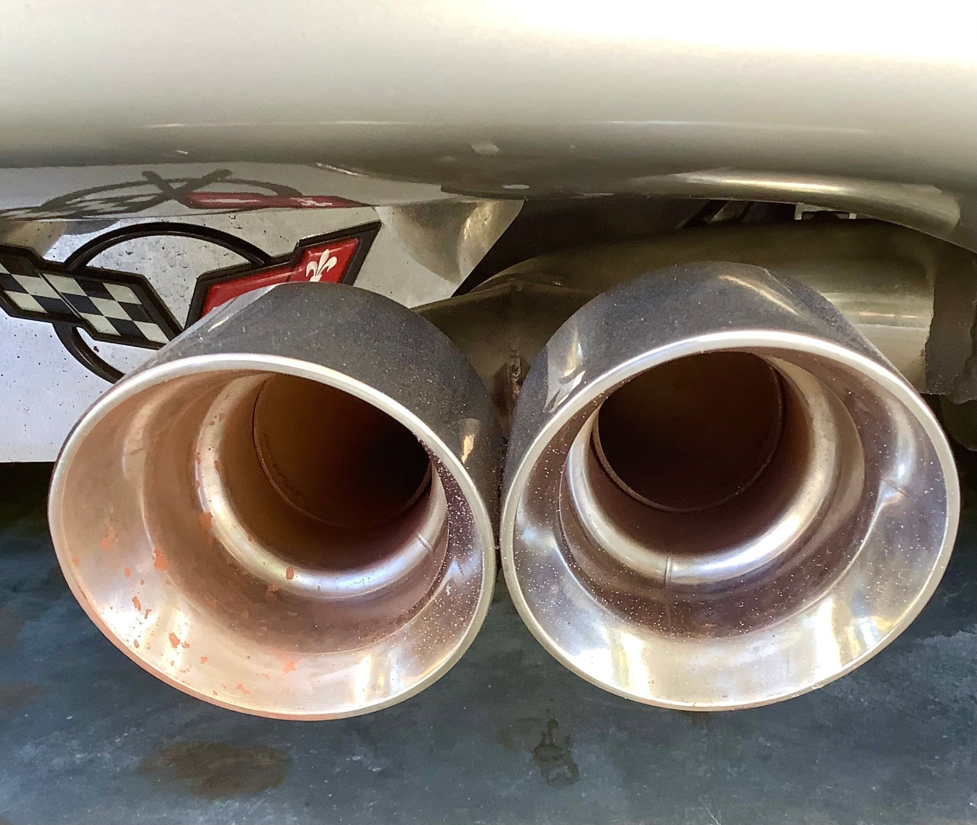

Recently, rusty dust has been showing up in my exhaust tips. This is a new one on me…
This past winter I swapped the cam, heads, water pump, hoses, etc…and disconnected the AIR system... When I first started the car it was spitting out rusty water and steam, but that went away after some driving and getting the tune.
It’s not nasty like at first when it actually corroded the polished tips, but I still get a small amount of rusty powder. Has me stumped.

Drain the coolant and refill with the proper mix of coolant and distilled water
Are you suggesting coolant is coming out the OP's exhaust?
If so, wouldn't the proper course of action be diagnose the leak and fix it?
Old Jun 23, 2024 | 10:01 AM
grinder11's Avatar
grinder11
Posts: 12,861
Likes: 4,664
I agree. BUT-OP-Engines do emit water vapor as a byproduct of combustion. You'll find that until the ehaust is hot enough to burn it off, it will manifest at the tips as liquid. I suspect the OP isn't running cats. This situation greatly affected the early Honda and Kawasaki 4 cylinder motorcycle engines with 4 individual mufflers. The small displacement of each cylinder wouldn't heat the pipes very fast, and many, including me, saw their mufflers rust thru from the inside out within a year or two. One reason you won't find 4 mufflers on any bikes anymore. FWIW....

If the exhaust is not stainless or a cheap metal it will rust and blow out with the condensation.
