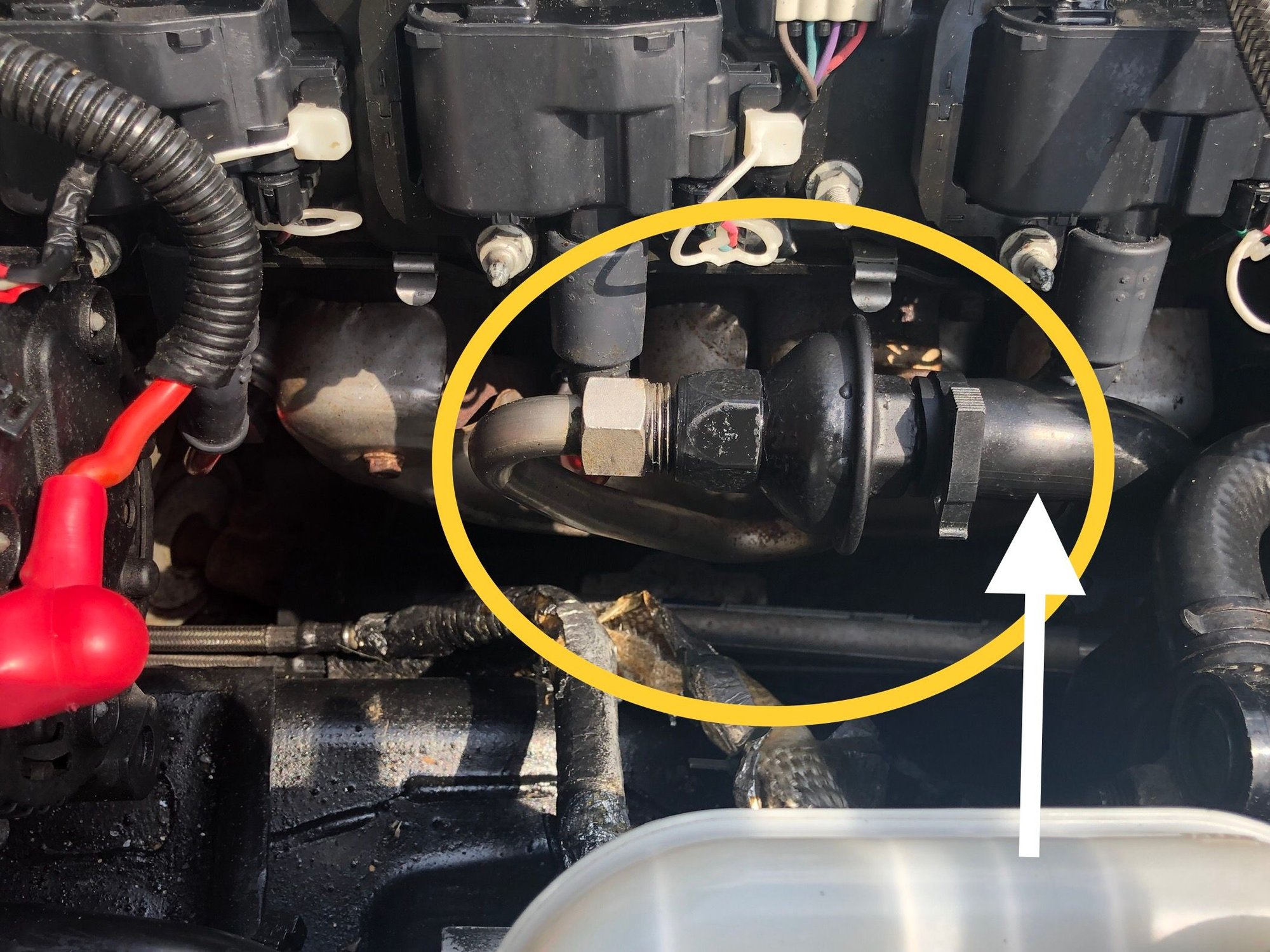

Well with your scan tool if you have one is to look at your IAT then disconnect the AIR fitting and see if the IAT is now lower…if it is lower then that is most likely your issue and no need to do a back pressure reading…curious what your fuel trims look like and your driveability issues like your idle surging…you may have negative trims on the left back and positive on the right side.

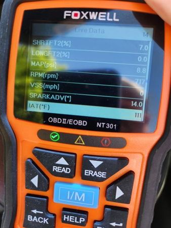

Engine at temp, ambient temp outside 90 degrees. IAT 111, Short trim 7 % at idle.

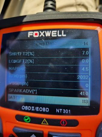

At 2000 RPM, IAT drops, FT unchanged.

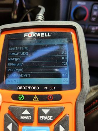

IAT pulled out and tucked into hood liner as high away from engine heat as I could get it. It went up anyway to 123. FT went to 10.2 at idle. I swear I could hear it pull timing.

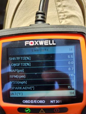

IAT plugged back in, revved a few times, temp drops and FT drops momentarily. MAP PSI doubled for a split second.
What do you think? Sounds like there is no vacuum being built. Cat is still functional?

Is these numbers with the AIR connected ??…if you removed the IAT sensor which is after the MAF sensor this is unmetered air that the MAF sensor doesn’t read so your fuel trims will go positive as you saw !!…you have a big vacuum leak…you would have to block that off…are you getting these values on the enhanced side or global OBD2…in global you don’t enter make, model etc…in global OBD2 the numbers you see can’t be substituted…what the engine computer see you see…in enhanced you may see a different temp than global.
I must be misunderstanding. I'm not sure what the AIR is? Do you mean the fitting on the exhaust manifold from the air pump? The Foxwell is in global mode.
Yes !!
