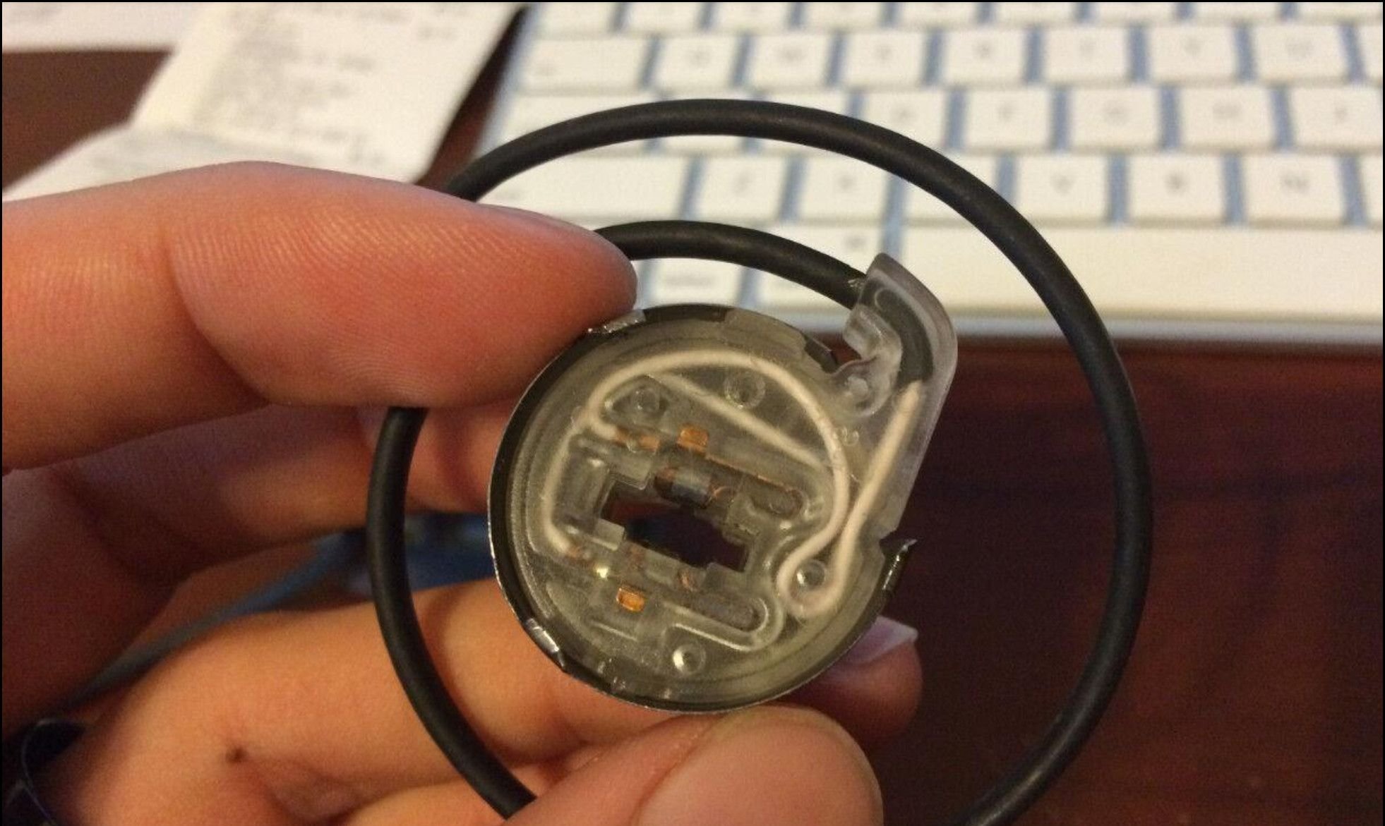

The slipring could be checked with a multimeter measuring resistanse and the slipring may need som cleaning (contact cleaner) or som careful bending to provide more sliping press on the ignition key .
New ignition switches does not have the same quality as they used to have . Keep this video in mind if problems still appear after replacing the ignition switch

It seems like this ignitionswitch all we can get .
I can recommed to look through this video if a new switch fail and do what this guy does when he repair his new China ignitionswitch
