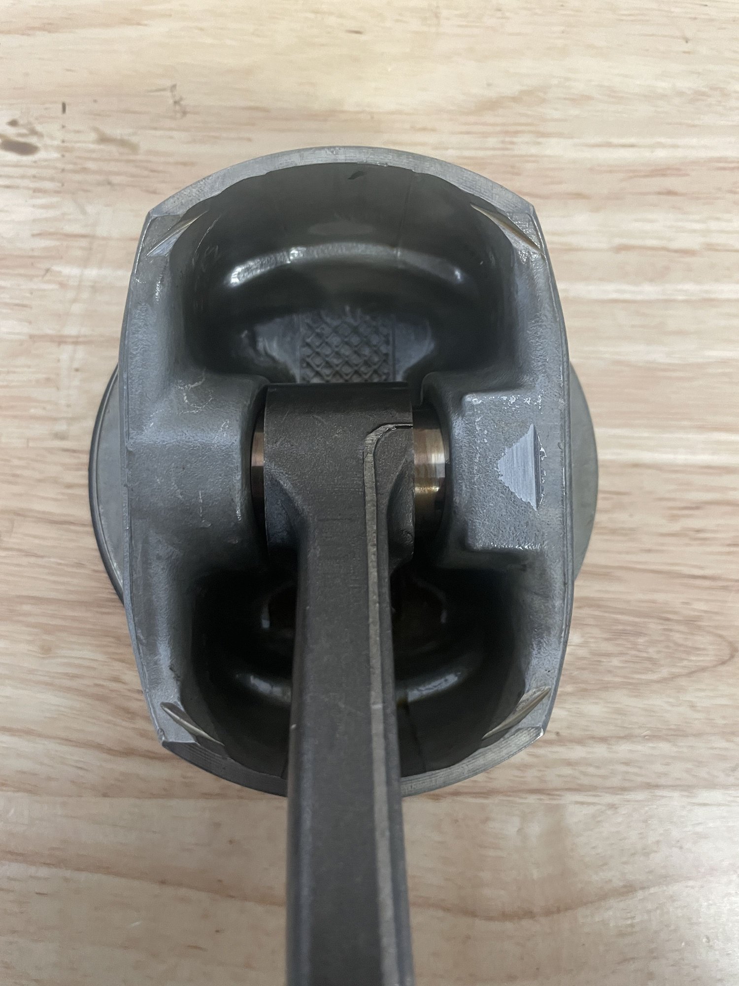

Update:
The source of the tick is a bent connecting rod in cylinder 7. The noise was coming from the piston skirt right below the wrist pin hitting on the crankshaft counterweight. See attached images.
To find the noise, I went ahead and pulled the oil pan (not fun by the way) and saw that number 7 had a slight bend in the front to back direction, that led me to remove the heads to pull out piston 7. When I removed it I found the bend in the up down direction to be much worse (as pictured) than the bend in the front back. I found a small scrape under the wrist pin and believe that is the source of the sound. I inspected all around the counterweight looking for damage from the impact but couldn't find anything more than the smallest scuff where it rubbed at bdc. There is no damage to any other part of the crankshaft and there is no wear to the bearings or mating surfaces. The reason for the tick tock sound must be the difference in pressure between intake stroke and power stroke.
I now have to diagnose what caused the hydrolock in the first place. Due to the low miles the oil trail on the intake port tells a story, when comparing the oil residue from intake port 7 to the rest you can see the sharp perfect spray pattern on all the rest but on 7 the line is much softer with oil grime going further in. This makes me think this injector had a bad spray pattern in the past and likely finally just gave up and failed flooding the cylinder. I attached a photo of intake port 7 (in the back) and 5 (to the front) to showcase what I'm referencing.
The two options are electrical failure or injector failure and given the assumed spray pattern and overall likelihood I am lead to believe it was a injector failure that caused the hydrolock. If that is the case I will replace all the injectors with new likely aftermarket injectors to prevent another failure in the future. Advice on good injectors would help, not looking for power adder just similar spec to oem.

That should get you started seems like you know what you are doing. Pulled it apart pretty damn fast I'm impressed. Just remember if the engine gives you trouble for re-assembly, or machine work is done wrong or taking too long, you can always get a high mileage reliable replacement engine for very affordable, an L33 (05-07 5.3L Aluminum) is damn good solution to a blown expensive engine time constraint syndrome.
