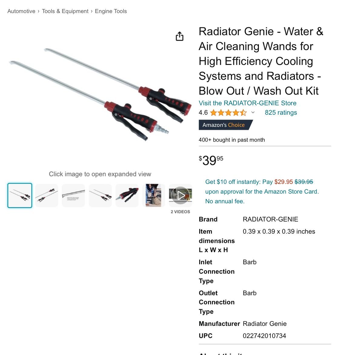

It’s amazing how much the junk in the condenser and radiator affect cooling. Well, duh, right? It’s just that these cars are very susceptible to debris. Every time we drive over grass cuttings blown into the street, we’re taking some home…. Even on a 90°+ day in Florida my engine coolant rarely goes above 205°. If you’re going from the gauge, it might read higher. Use you “Gauges” button on your DIC screen to coolant temp and it will be more accurate and precise.
To clean the condenser properly it is a chore removing the air cleaner and radiator cowl from the front. But that’s the best way for a thorough cleaning.
Next best is removing the cover above the radiator and using air and water wands.
Radiator Genie - Water & Air Cleaning Wands for High Efficiency Cooling Systems and Radiators - Blow Out / Wash Out Kit https://a.co/d/06b0R2oP
