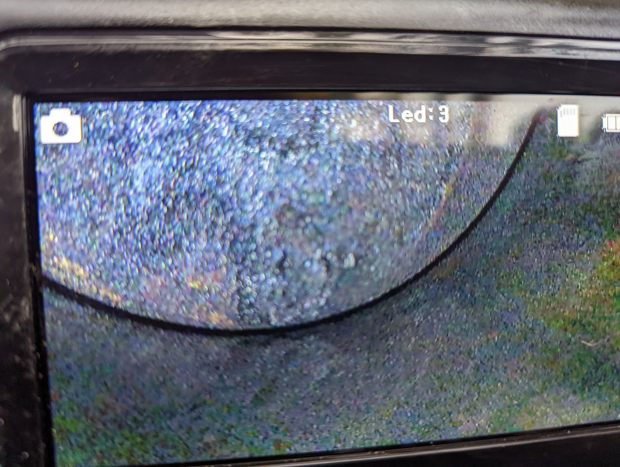

Got around to removing the spark plugs on the drivers side and stuck my camera in to see any signs of coolant. This side has a lot cleaner looking spark plugs but with a bit of red coloring on it, which might suggest I've tuned it too lean. One of the things I was going to do was put in a wide band sensor for this reason. The spark plugs on the passenger side were entirely black, like it was running too rich. With that bad lifter I wonder if exhaust gasses were making their way back into the intake? I think the valve that wasn't opening was exhaust? It's the 4th from the rear.
Did my best to take photos of the combustion chamber. Wanna see what people here think.

Actually red is good proper fuel mixture. lean is white

Yeah, if you are running fuel additives. I have never seen a red electrodes on anything but motors running fuel additives, and a red color is not indicative of a normal/good fuel mixture.

That's just 93 octane gasoline. I'll get around to taking a photo of the other spark plugs. Before this happened the Vette would start up smelling like it ran rich but eventually it wouldn't. I did tune it based on the O2 sensors on the car.
