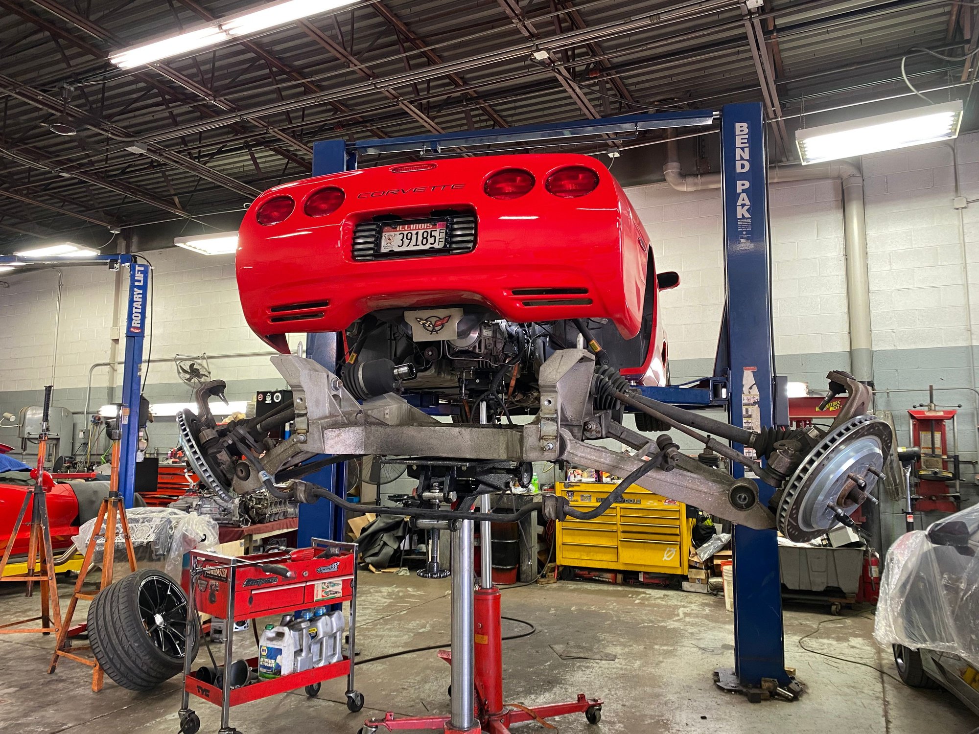

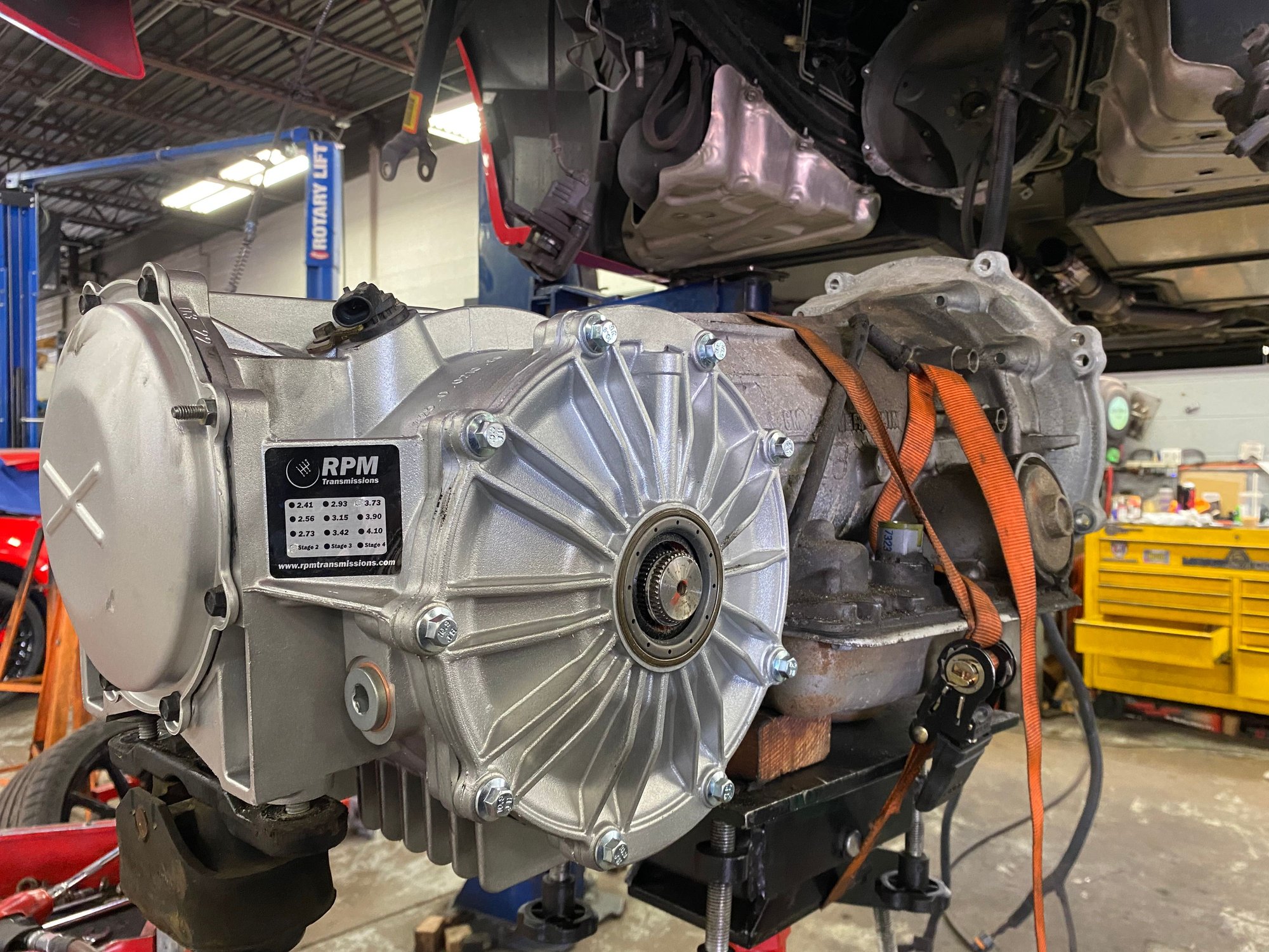

You have to drop the entire back of the car. It’s not impossible. People have done it before on Quickjacks.
compliments of Speed Inc
They said they were going to throw a trans service in my purchase. It’s not documented, I didn’t pay for it. I doubt they did a trans service.
it looks like they left my TT in there, just removed the trans and diff

The 3.42 differential from a manual transmission C5 will need the adapter plate cover insert #12554838 to work behind the automatic transmission. You can call either one of these shops for details;
https://rpmtransmissions.com/
https://www.rktperformance.com/
