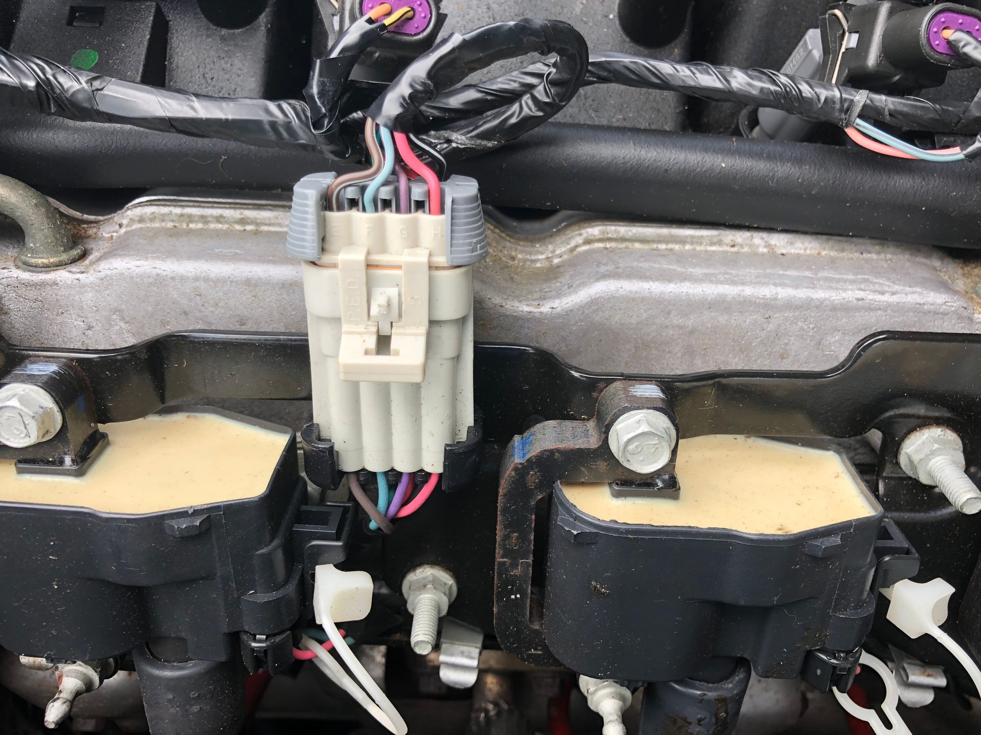

Well thinking it may be something like a bad coil pack ground (C107) which is located on the back side of the left cylinder head…if you can back probe terminal A (black/white wire) on the connector which is located in the middle of the cylinder head on both sides of the engine and run a wire to a clean ground from both sides…it’s called a bypass test…if that ground has high resistance you will not see the correct current which each coil pack produces…around 4 amps…just trying to throw out some things you can try if not using any diagnostic equipment.
I’ll be trying the back probe tomorrow. I did put all new delphi coils on when we did the initial tune up, but then again it was missing before we did that.
