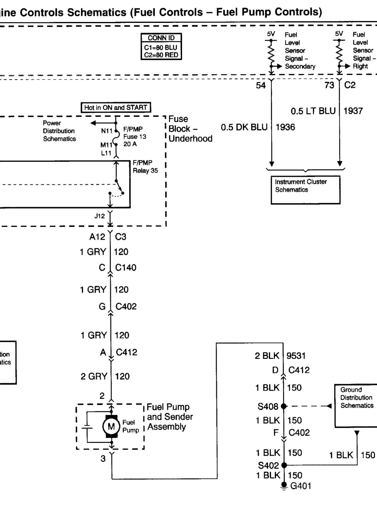

This is the circuit…as you can see there are a few connectors (C140,402, and 412)…you will need these to figure out where and if you have high resistance in the pump circuit…C140 is one of the connectors outboard of the battery…C402 and 412 are also on the ground side of the pump circuit along with G401 which is located on the left frame rail and can be seen with the left rear tire removed…I’d check G401 first…you can even check current flow on the pump circuit on the ground side with an amp clamp too.

G401.

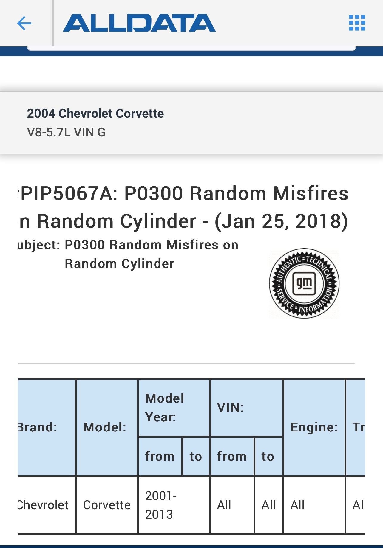

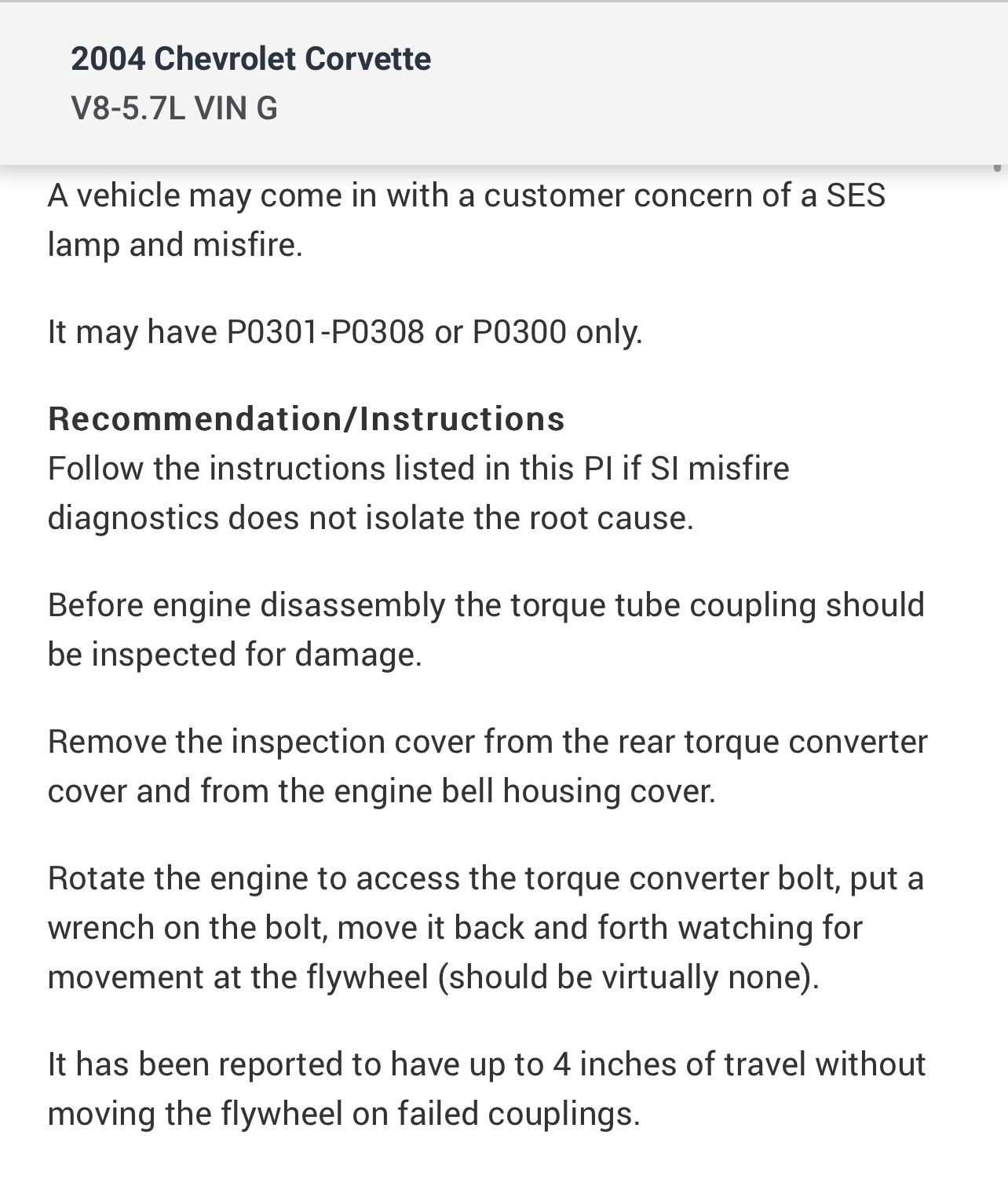

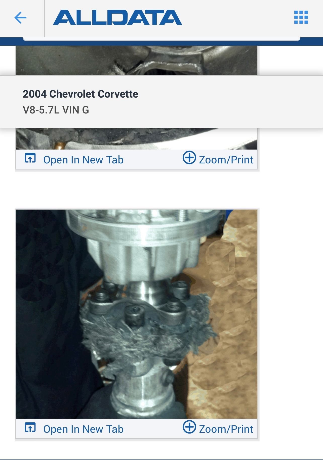

it is definitely misfiring. You can feel and see it. But it’s not 1 cylinder going up to 30 misses consistently. It will be cylinder 4 30 on one cycle, cylinder 1 27 on the next cycle, cylinder 7 25 on the next cycle and so on. While the rest consistently read 6-10 on each cycle.

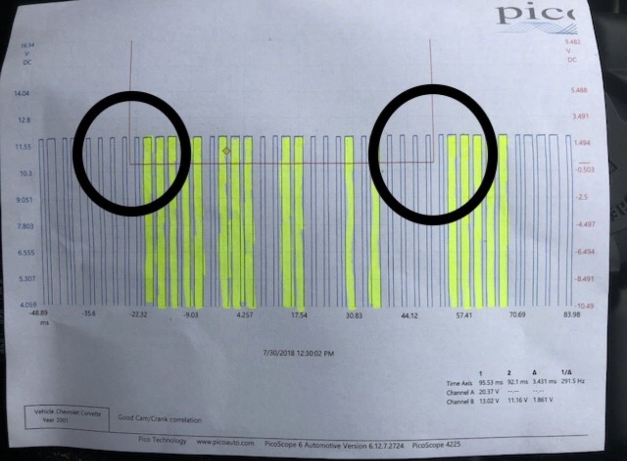

Your fuel trims look OK and the car has no issues starting or backfiring so I don't it has shifted radially...to check for a radial shift occurrence a cam-crank correlation with a scope will need to be done...below is a cam-crank from my 2001...cam is a 1X and crank is a 24X...there are 24 pulses between each cam sensor signal...if the cam and crank leading or trailing edges don't line up like this picture the reluctor has shifted radially...red is cam and blue is crank....you can remove the crank sensor and maybe see if the reluctor has moved axially which will diminish the voltage you see...0-12 volt square wave,..you may only see 0-8 volts.
It actually has been having trouble starting lately. But its really strange. It'll crank but not start and then the second try everytime will fire right up. I will definitely have to get it scoped it looks like.
