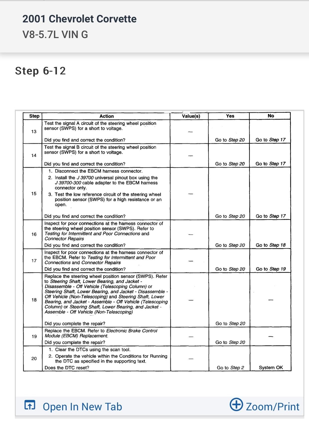

If you have a scan tool and can read some data PIDS using this diagnostic tree and have some electrical experience this may help you.
