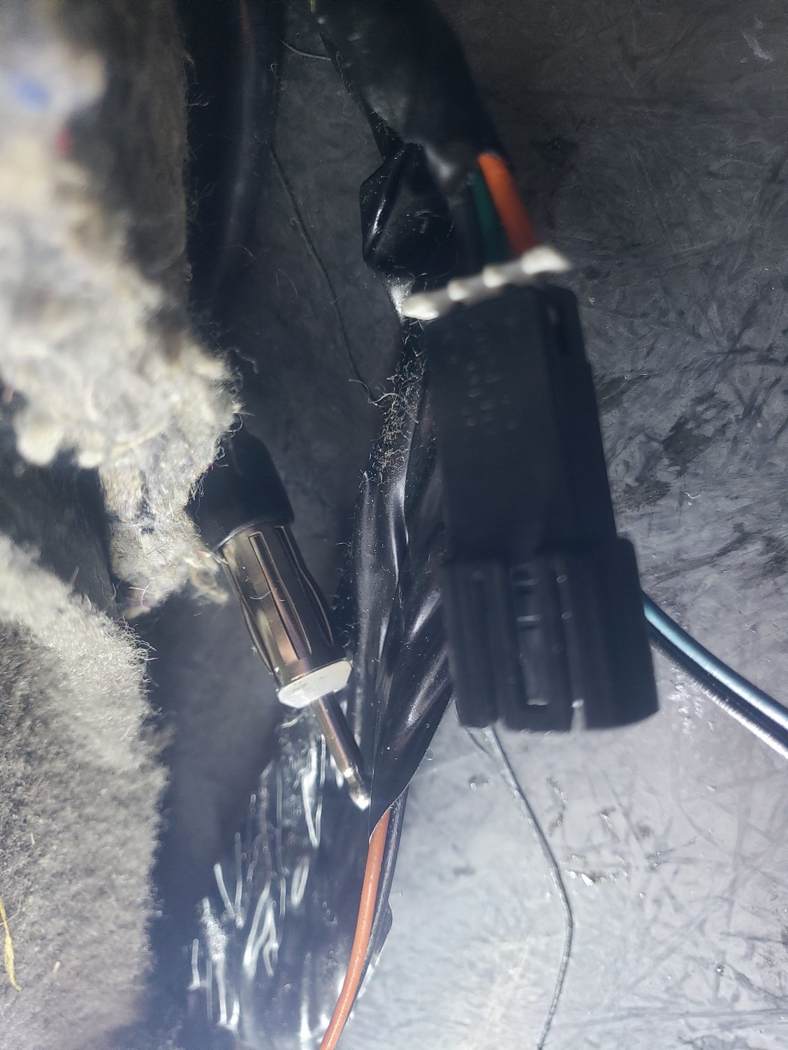

1. Antenna Cable: the original antenna cable terminates in a female. The Metra terminates in a male. Buy Metra adapter 40-UV41.
2. Motor wiring: The original unit has a specific connector to mate to the car wiring. The Metra unit has spade ends. Cut the end off of the original unit and connect it to the Metra unit.

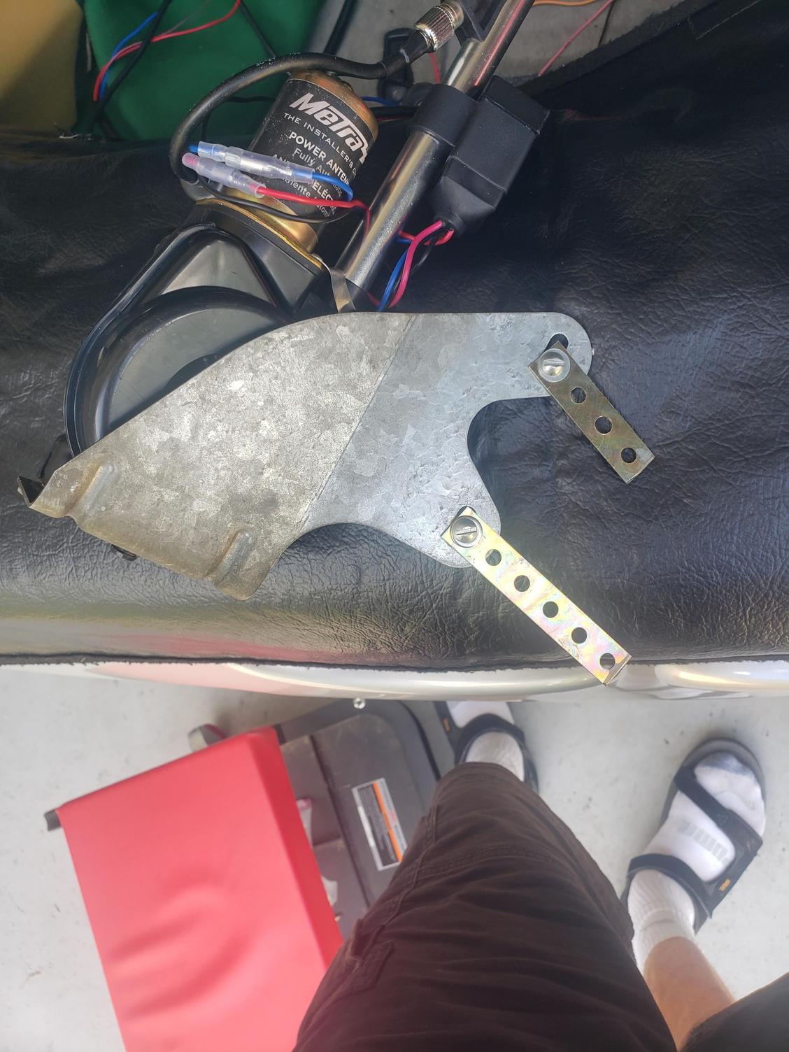

3. Mounting bracket: The Metra unit will mount to the original Harada bracket with a slight carve-out on the bottom to accommodate the drain hole on the Metra. However, the bracket will not then mount to the wall. Use the mounting strip from the Metra unit to accommodate the difference.

the original unit wiring has a plug that matches to this female on the car.
remove this male plug from the original and use butt connectors to attach it to the Metra unit. Metra (M) Red to Corvette (C) orange. M Black to C Black. M Blue to C Green. This got a little confusing for me, so I diagrammed it out to make sure I got it right. Thanks to the Metra tech guy for leading me through it.
mount the Metra unit to the original Harada bracket. The Metra unit mounts to the plate; however, you may need to cut out a small section to accommodate the drain hole on the Metra. The Metra sits on the bracket differently than the original unit, which won't allow it to fit to the bolts on the trunk liner. I used the mounting strips from the Metra package to make it fit.
