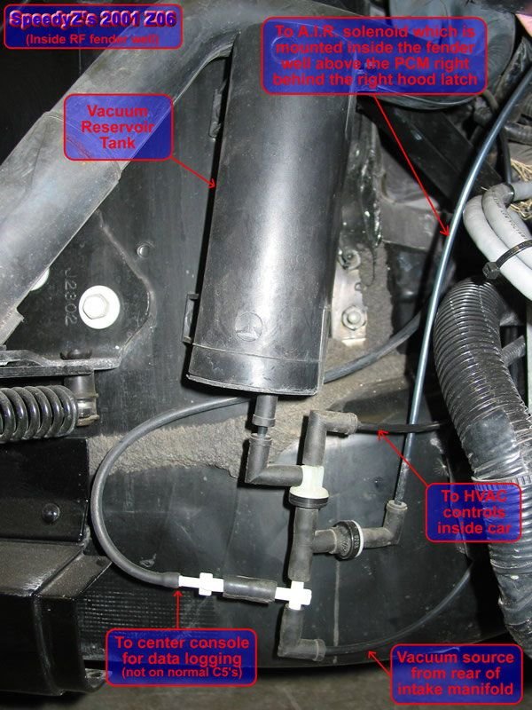

Do the air paths change when you select different modes? As you have noted, the volume of air movement should change considerably between fresh and recirculate. Leads me to wonder if you have a good vacuum to the control valve.
I have yet to hear of any reasonable access to the evaporator, even just for cleaning the outside of it.
Air direction is controlled with vacuum signals, and air temperatures controlled by electric actuators. If the a/c light stays illuminated with the system on, then you should have at least a modicum of refrigerant — though not necessarily enough. Air modes are less important than cooling — misdirected cool air will still cool the cabin. Been there.

I had this exact same problem about 8 months ago. Air flow and temps changed with the controller but regardless what mode I was in, the air came out of all the vents at the same time. This caused a very weak air flow. I took a cfm meter and at the dash vents I had 125CFM. The blend doors are vacuum controlled and electrically operated. I had a leak in one of the vacuum lines behind the passengers side wheel well. Once that was fixed, the CFM was 523 if I remember and you could hear the doors operating.
