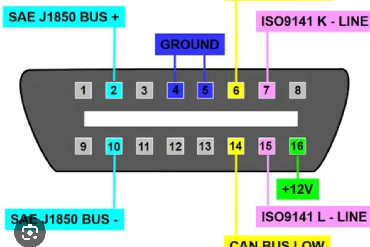

If you have and know how to use a DVOM check the voltage on Pin 2 on the DLC when those issues pop up…you can use pins 4 or 5 for your DVOM ground…if there are no communication issues on this wire which all the modules communicate on you will see maybe .2 to .4 volts which fluctuate with key on or engine running….is pin 2 is shorted to voltage you will see system voltage…with a lab scope you will see a digital 0-7 volt square wave if there are no issues.
