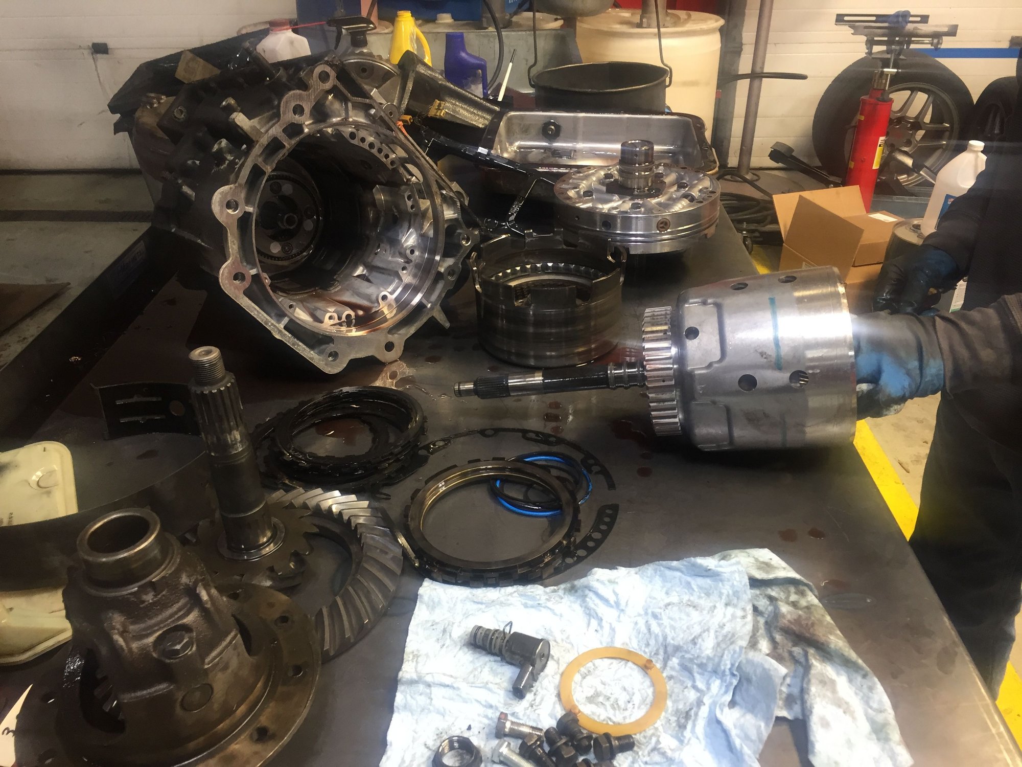

There is no reason you can't rebuild an automatic transmission yourself. I did a rebuild on my 2003 Acura TL in my backyard and basement. I got the ATRA (Automatic Transmission Rebuilders Association) manual for the transmission and Cardone rebuild kit from RockAuto. Pulled the trans, dragged it across the yard and down the cellar steps. Broke it down to sub systems on the cellar floor and rebuilt them on the workbench. Put them all together on the workbench, slid the assembly to the floor and buggie-lugged it up the cellar steps, over to the car and put it back in. With the ATRA manual a cave man could rebuild a transmission. Take your time, match the drawings to the real thing, match the parts in the kit to their originals, keep everything clean using brake cleaner and freezer bags. You will find out what happened and you'll have the parts to fix it.
Have you ever met Einstein working in a transmission shop?
