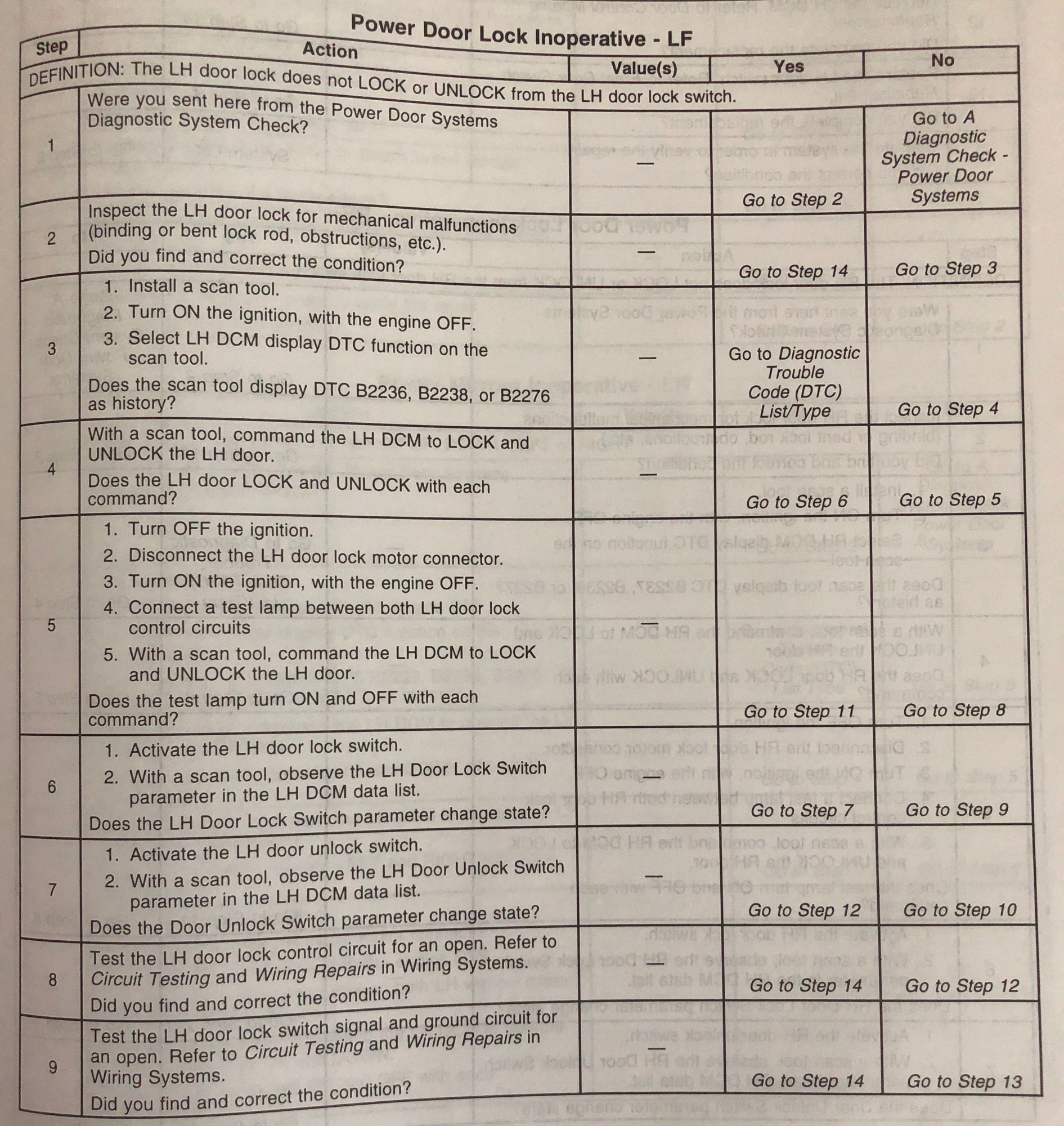

If you don't have a scan tool I'd probably try @maceHardware's technique from their thread and apply power directly to the actuator motor, like the door lock module should do if it were working properly. At least you can rule out the motor that way.

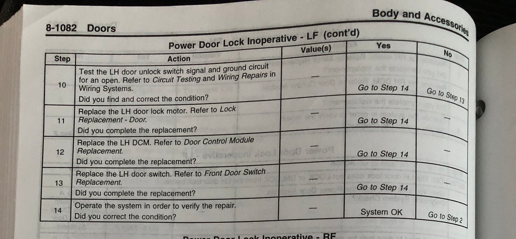

Troubleshooting chart from a 2000 service manual.
