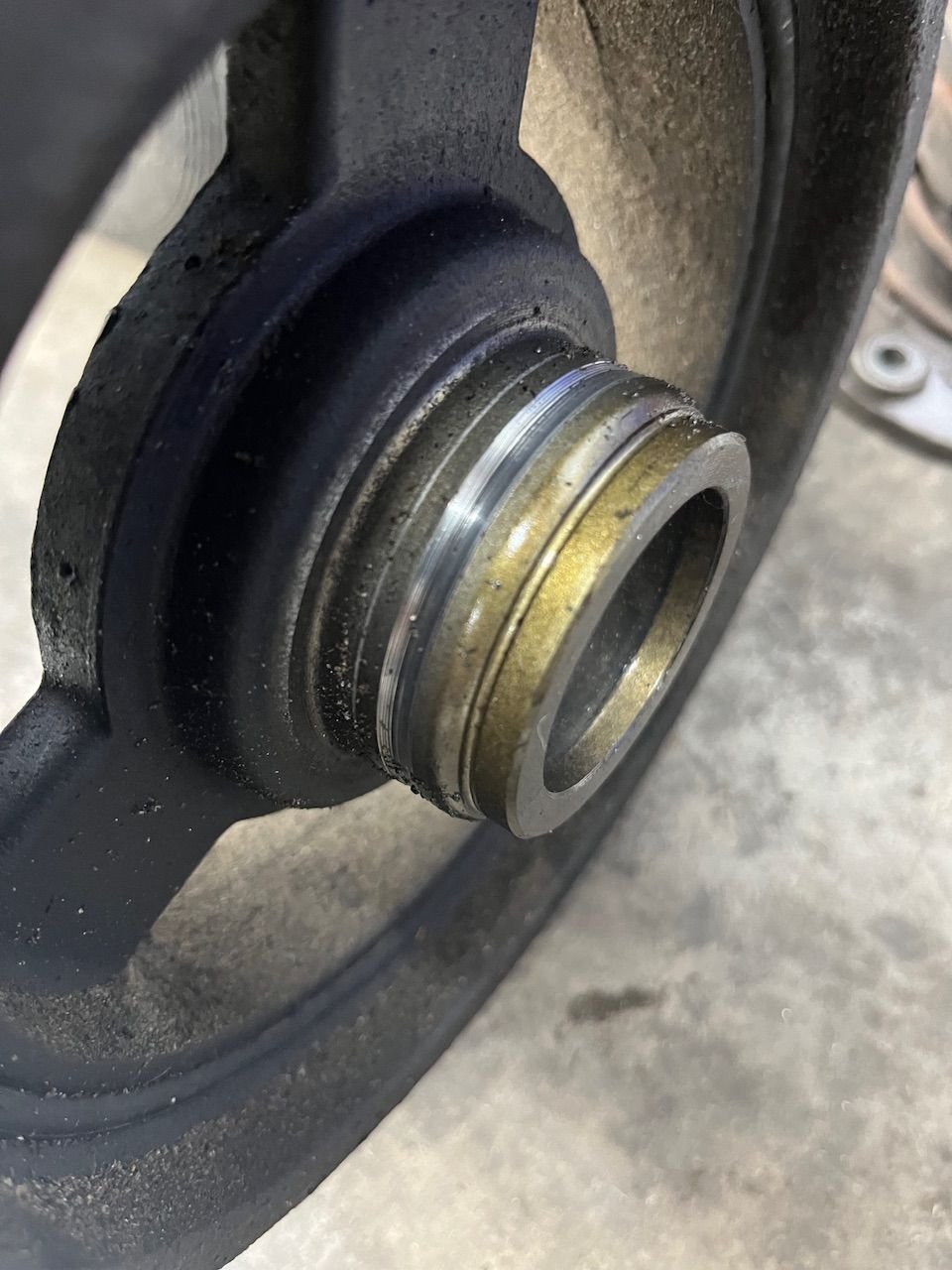

I have 85k on mine with no wobble - I make sure to drive it year-round. When I took it to ECS for clutch and torque tube they found I was leaking oil at the front (that was a surprise - I had expected rear) - and the reason was that the front seal had cut a groove into the balancer resulting in the leak! Damper and seal replaced…
I just replaced mine a couple months ago, it was wobbling a little bit, but not bad for 177k. But the oil leak, yuck. When I removed my balancer I had found the same groove worn into mine.
