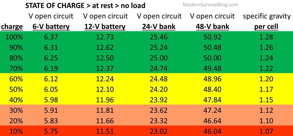

A FLA battery with 12.4 volts is less than 80% charged…a fully charged FLA battery is 12.66 volts…by “car stopped” do you mean engine off or the car not moving ??

A new fully charged battery should read 12.7- 12.8 volts. If you are not well over 13 volts running, you have a charging problem

Fully charged 12.6 but used battery’s and most corvettes sitting as much as they do will be found at 12.4 and still start. That is bathe low end where it will still start. Actually it is 75%.
Running 13.4 to 14.5 depending on temp, load and battery
All these numbers can vary a volt or two. The DIC is not always in agreement with a volt meter,
Either way these numbers are with in operating norms. If it is below 10.5 volts batteries especially glass mat batteries get funky and won’t take a charge unless you have the proper charger. This is why so many think their Optima is defective. Generally it is low and they are using the wrong charger.
