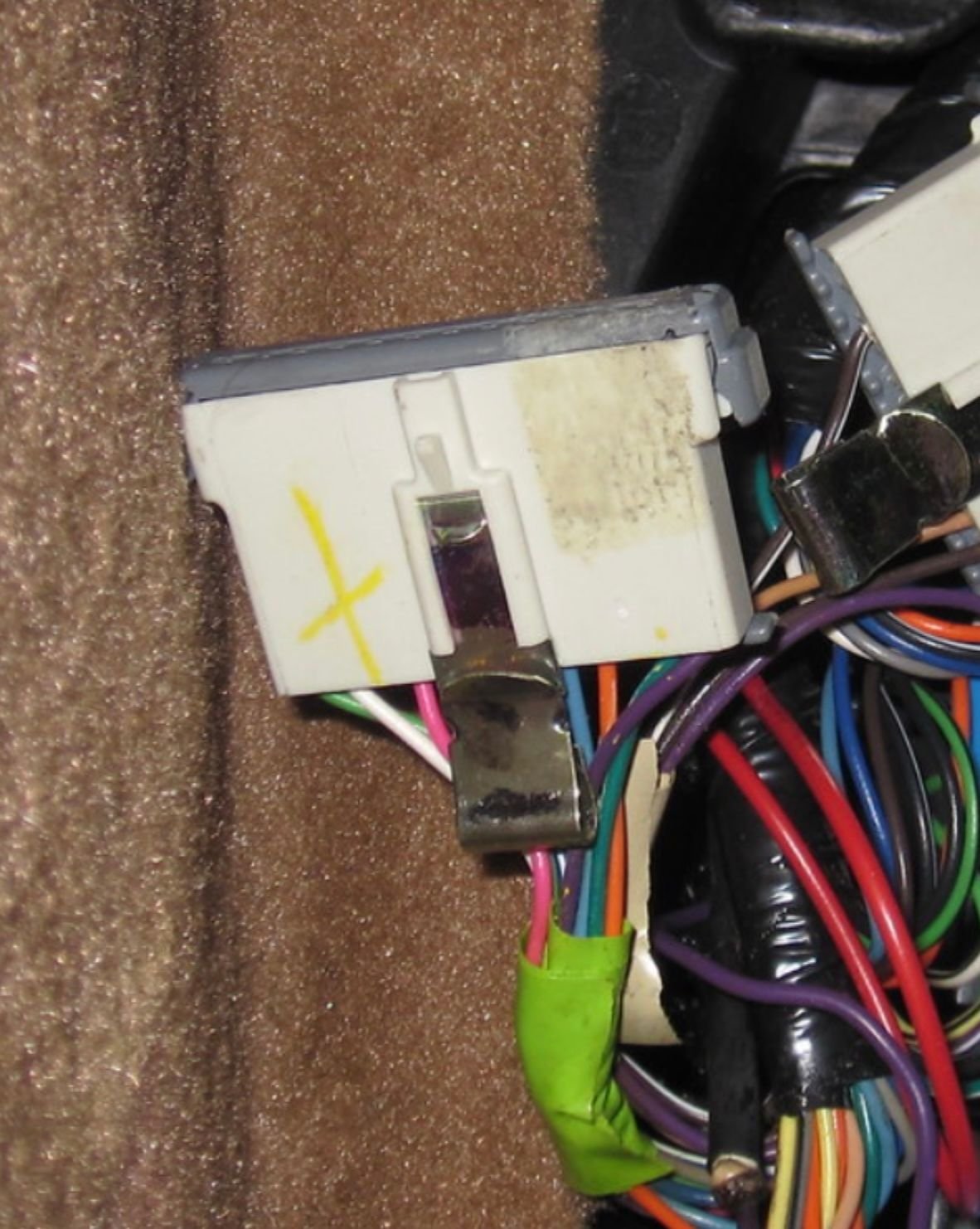

There are two connectors by the BCM that have metal jumpers or as they are called here combs. This combs are where the seriel data highway wires are all connected together. There is a video which shows how to remove the combs and place a wire jumper which connects only the BCM and PCM, eliminating all other modules, and possibly helping pinpoint the problem to the BCM or PCM.
Well, you won't find a reference for "combs" in service manual or schematics. They are called "Star Connector 1" and "Star Connector 2"
....scroll to post #6
https://www.corvetteforum.com/forums...-there-is.html

FYI….below is the Splice Pack or Star Connector per Service Info and the “comb” which those of us like myself that have been familiar with SAE J1850 (VPW) since the early 90’s have been calling it a “comb” or “buss bar” since that time…it is technically called a “shorting bar” in factory Service Info and if you didn’t know the original purpose of these splice packs were for programming of the modules.
Yes, we call them “combs” !!…the comb is the comb and not the star connector.
