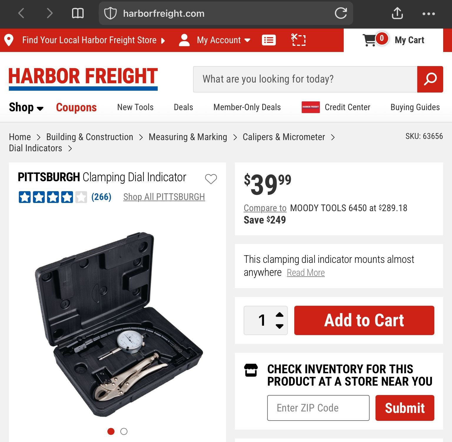

Here’s a clamping dial indicator base
https://www.harborfreight.com/clampi...H71Cql1vRoCmnY
good thing I have a harbor freight 5 minutes from my location!
