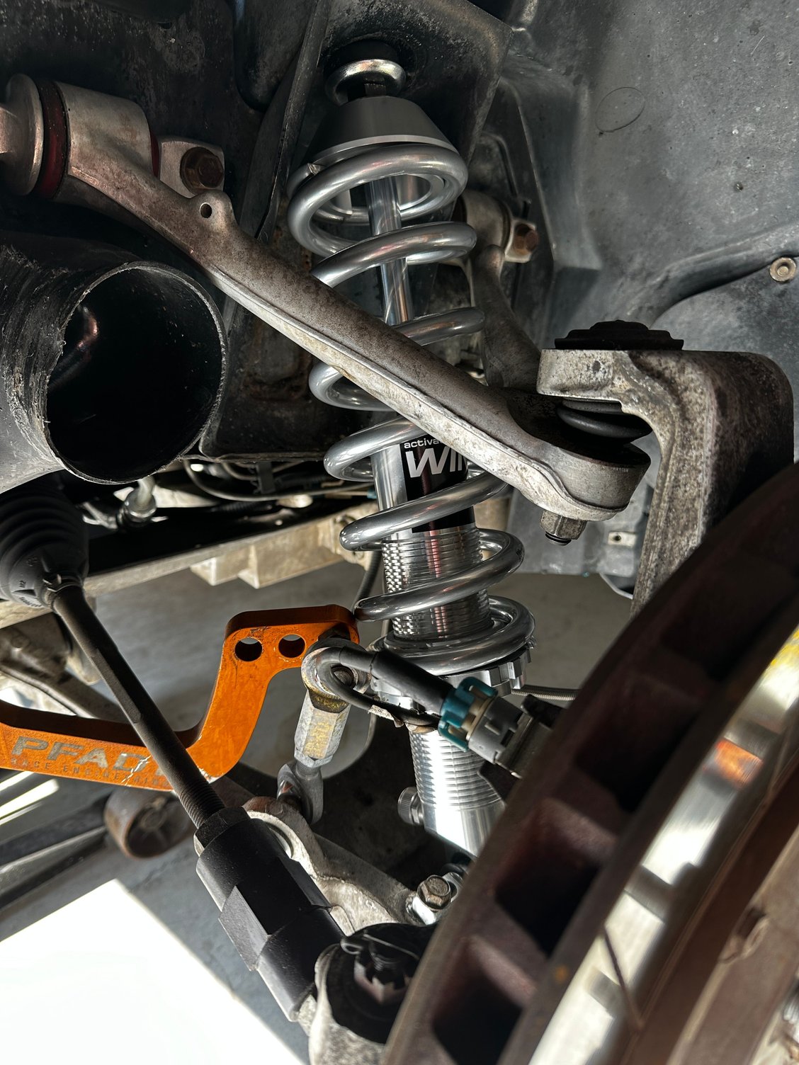

Default Vikings installed
I got the new Vikings installed over the weekend, I decided to drop 2 clicks from the settings posted by @miami993c297 . So far I like these settings, but I have not driven it much yet. I am impressed with the coilovers, although I think the biggest comfort difference is the coils themselves, the PFADT had some unknown but much more stout spring rates as they were installed for track use. The Vikings are so smooth compared to what was on it.
When initially installed, after settling a little bit on a drive around the neighborhood, the rear measured 26-3/4 floor to fender top. I still had no idea how much preload was required to gain 1/4-1/2" in ride height. So I added 1/2" of preload. That took it to around 27-1/2", so it gave me roughly 3/4", and coming from 26-5/8" ride height at all 4 corners when it had PFADTs installed, it seems super high. So when I did the fronts, I decided to start with adding 1/4" of preload. Turns out it is also right at 27-1/2". I'm going to drive it some and let it settle out and if needed take a wee bit of preload out. I think 27 to 27-1/4" is where I want to be, it's not so low that I cannot go over speed bumps but centers the tire in the wheel well more.
Anyway, I didn't take many pictures as I just never really think about doing it. But here is the driver front. Install is straight forward.
