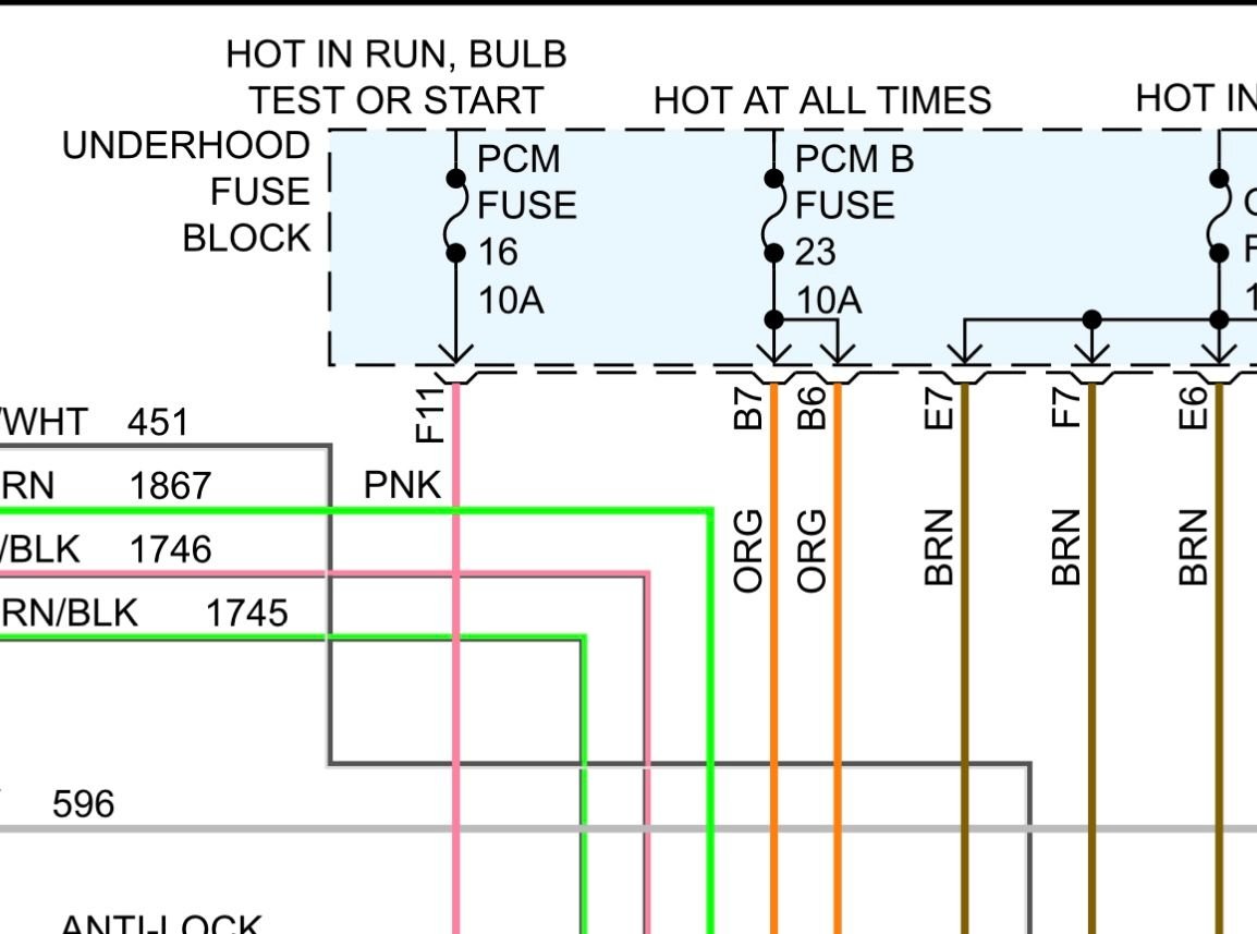

I'm installing a 6 pole master kill switch in my 2004 Z06, I'm having trouble figuring out what fuse or relay I need to splice into to kill power to the ecu, I tried the Powertrain Control Module fuse but that doesn't work. Any input would be appreciated.

Why are you installing a kill switch ??…not a good idea to be splicing in wires especially the PCM !!…FYI, the PCM has an ignition feed and a battery feed…there are 2 fuses !!

Will you be relocating the battery as well? The positive battery cable splits, one cable goes to the starter, and the other to the underhood fuse box. I would install an additional terminal block to facilitate the use of ring terminals....no splicing. Disconnecting the battery from the starter and underhood fuse box will kill the whole car.

Thanks, that should get me what I need the battery will stay in the factory location.
