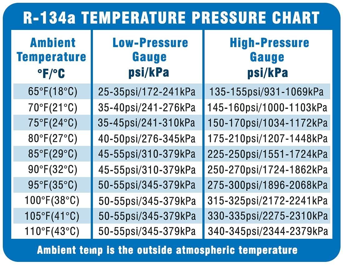

I've attached an R134 Charge table below.
